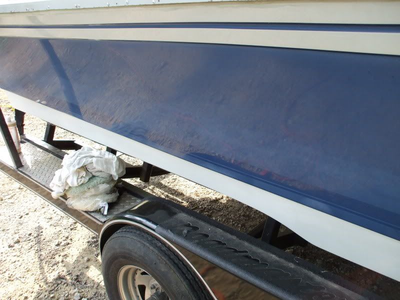

**when I tried it with just compound this is what happened**
I have took my porter cable 7424 orbital buffer I use on my cars and bought some meguaires compound # 49 and tried it and it isn't enough cut.

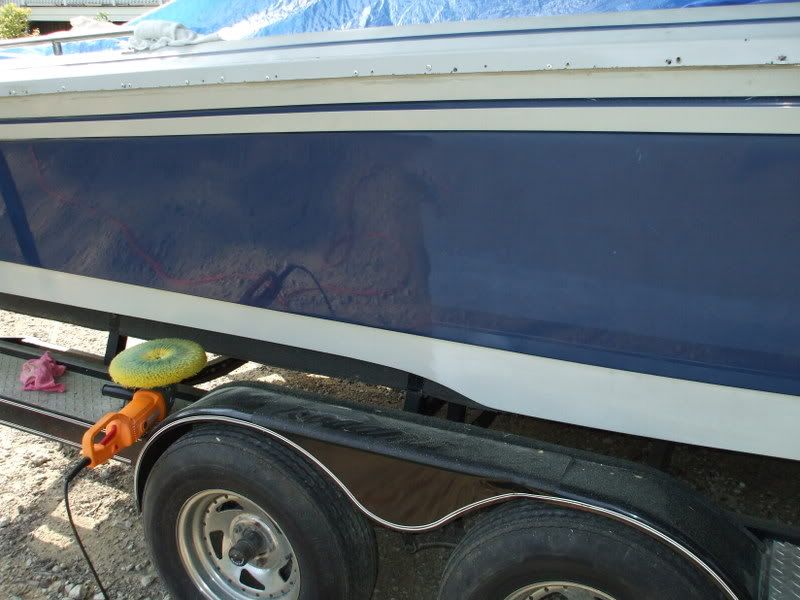

this is what i'm working on:
during...i'm also going to use a polish in some areas and wax it
change your pads out often or de-bur, need something clean to wipe the junk off
oh yeah, i don't have pics but i also did my stainless rails. cleaned em up real good. made a mess of my rags.
