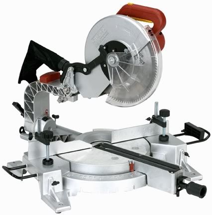

I just picked up one of these, on sale, sale for 149.95. It is a 12" sliding compound mitre saw with 80 tooth carbide blade and a laser beam. A lot of saw for the bucks.
