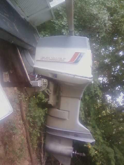

I am restoring a 1986 TX17 bass tracker and am looking for a motor. I am kinda on a budget so I am more than likely going to end up with something older but I am thinking it will be better anyway because the older stuff is simpler to work on. I have a guy that has this motor for sale he says I can test before I buy. Its a 65 Evinrude. Can yall tell me roughly what year it was made and if it would be a worth while purchse? I realize it has not tilt and trim but I would add that later down the road with a CMC plate. He is asking 800 which I think it pretty high. Any thoughts and suggestions welcome, Thanks Aaron

transom tag numbers are needed. from the pic......id be very cautious.

the 65 3-cylinder was only built in 1972 and '73. The '72 has an electric-hydraulic shift system and uses the yellow plug connector for the boat wiring harness, and has the unreliable battery-points CD ignition system. The '73 has the magneto powered ignition that was a lot better and a mechanical shift gearcase with hydraulic assist. It has a red plug for the main connector.
