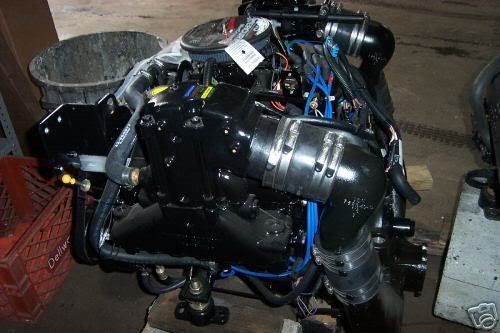

Re: Is it worth it ? 1997 Chaparral 1930 Sport
here's one the the manifold, riser, elbow set up.
Thanks for the pic.
So is this a deal breaker ? The boat is reasonably priced already from what I can tell. The conversion kit is about $800 now and I could easily do the work.
Does the engine have to be pulled to replace the manifolds ?
the engine does not have to be pulled, but you need room to work, if the dog house is removable makes it much easier. i also found using longer bolts to get it lined up really helps, then install the correct bolts.
as far as a deal breaker, i would say not. just explain the the seller, what the cost will be to replace them. you in fresh water may get several years out of the existing ones. but, when you go to sell it. and someone is as smart as you, comes to iboats, they are going to get the same warning from me.
my point is to enlighten you on the situation. not to discourage you.
the setup was excellant. i think the cost of casting those big batwings, was the reason for dropping them.
