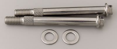

Don S or Bomar76 please explain the stater bolt idea to me! I thought if a person got the same length and shoulder as the original bolt. I don't see what the defference would. Maybe something I'm not seeing!

It's really simple, starter bolts are special design, not standard bolts. Note the knurling just above the threads. This is to take up some of the extra space in the bolt hole of the starter for alignment with the flywheel.
Coors
Dec 8, 2006
3,367
Re: is there a special tool for this
Reel, good pic, saves explaining; you been out for a while.

OK thank you I got it yeah!!! I see said the blind man as he walked into the lake!
I apologize for my ignorance. Thanks for the explanation!
