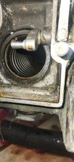

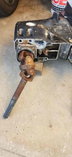

I just pulled my OD, an OMC Cobra. I have a leak and a vibration. Water was getting into the U-Joint bellows. That caused rust on the U-Joint and damage to the U-Joint bearing. (there is another post about that called XXX.)
I thought that I was careful to prep the surfaces well last time. I cleaned off all old gasket material and use a good sealer. I'm not sure how the water got in. Is there a way to check for a leak after the OD is back on the boat and after the first time in the water?
That could have saved me an expensive repair.
See pictures of the transom surface after prepping it for the reinstall. That may not be for a while because I have to decide how to repair the U-Joint.
Also, are there better quality, and maybe thicker gaskets that prevent leaks? Last time I used Sierra brand.

Leaks from the gasket between the drive and the pivot housing won't put water in the bellows. It will let water in the recess where the shifter bell crank moves, but not in the bellows, they are separate. The Sierra gasket for that is OK, what I do is coat the gasket on both sides with OMC gasket sealer and also on the sealing surfaces of the drive and pivot housing. That does keep water out of the recess where the shift cable/shifter bellcrank are located.
The only ways for water to get in the bellows is a defective bellows, improper installation, or rarely the grease tube that is for the gimble bearing. I have heard of that but never had that problem. Water can get in it also if the bilge is flooded but that's a very obvious problem because the water level would have to be as high as the driveshaft!
Unfortunately there is no way to know if water is getting in after you put it all back together, this is a basic problem with all I/O drive systems, be they OMC, Merc or Volvo. This is why the manufacturers say to pull the drive for maintenance each season but a lot of people especially in fresh water don't do that. Here is salt water it is a must, I have done this every year, for close to 20 years now. Next boat will be an outboard for sure, I can do this work but don't want to HAVE to do it, for years to come.
When installing the bellows I would use only an OEM bellows. In my experience if you store the boat with the drive down, the bellows can easily last 10 years. As soon as I see small cracks starting to form in the rubber between the folds, I replace it. The one on the boat now is 8 seasons old and looks good still.

Thank you Lou.
Re a leak going into the shifter recess and not the bellows, thanks I did not know that. I found a hole in the bellows at the 11 O-clock position where a clip for an anode ground strap should have clipped into the hose clamp. It looks like it made a hole in the bellows and caused the leak.
