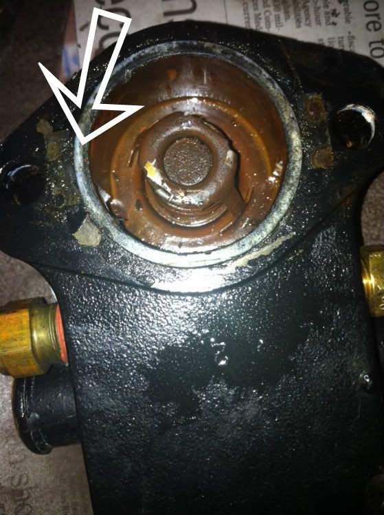

Does anyone know a good way to get this "sleeve" out (the grey ring around the rusty thermostat)? It seems to be holding the thermostat in...I just don't want to force anything and break it.
Don S
Honorary Moderator Emeritus
Aug 31, 2004
62,321
Re: Is Thermostat causing my temp guage issue?
Many times rust builds up behind the insert. Breaking them may not be avoidable.

I got it!!! I had sprayed some pb blaster on it and let it sit for an hour...wouldnt budge so I sprayed more and let it sit probably another hour or two. Came back at it with a pair of pliers...I was standing on it and pulling up at the same time and it finally came out....and didnt break! I'll be putting everything back in tomorrow evening.
Thanks for all the help.
