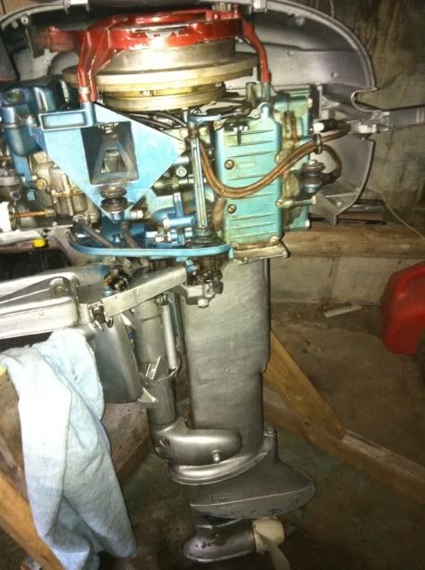

This is my motor. Seller says it's a 1956 15hp, but I'm not sure of the Model. I didn't see anything on the motor denoting the Model(maybe I missed it). Someone repainted it so I can't tell what it is.

I wouldn't know an Aquasonic if it ran over me in the creek, but I have a '56 Fastwin, and that picture, my freind is it.

You definitely have a Fastwin. You're lucky (versus an Aquasonic). It's a fantastic motor;probably one of the best built. Good luck with it.

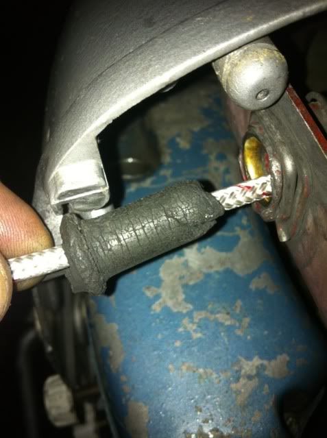

What is this rubber thing called? Is it supposed to rest in the recoil hole or where the two halves of the cowling meet? Is it something I can find at a small engine shop or am I going to have to order it online?

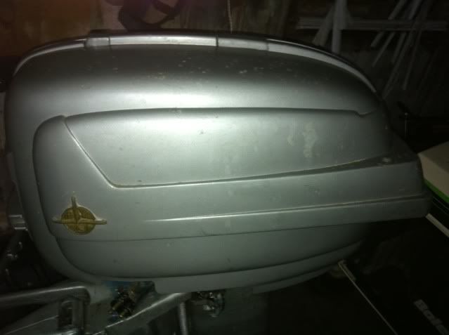

The rear half of your lower shroud is missing and so is the lower rubber seal for it.

I need the front screw for the cowling (part# 203300). Anyone know the size? Can I get it at Home Depot or Lowe's etc? Different part numbers for the front and back cowling screws....are they just diff lengths or diff thread also?
Chinewalker
Aug 19, 2001
8,902
Re: Is this a 1956 Fastwin or Aquasonic?
They are basic fillister head screws, 1/4-20 thread. Get them in stainless if you can.
As for the rubber bit - that's a broken off piece of the pull handle. They split at that rib, leaving you with that piece along for the ride on the pull cord. If it were me, I'd slit it and remove it from the cord. At some point, find an intact grip... The correct one will have a stylized E on it, sorta like the emblem on the side of the cowling.

Another thing I notice is you have a hand starter from a Johnson and it has a different pull rope handle set up than the Evinrude does. On the Evinrude pull rope, you have a little brass tube that fits in a groove where the clamshells meet. You will see item number 17 in the attachment below.
