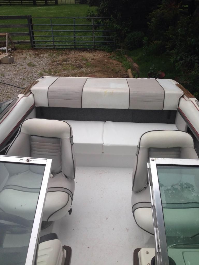

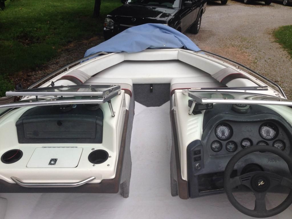

As some of you know ive been struggling getting my roommates 3.0 engine up and running after changing out my ignition for electronic ignition so I took it to our local boat repair shop and they got it timed and running for about 30 seconds and realized cylinders 3 and 4 had water sitting in there after it cut out. So they call me and let me know that its possible that the block or head is cracked. Now I dont believe the boat was properly winterized by the owner, he drained the block of water but never flushed they system with antifreeze. Im going to pick the boat up from the shop and take off the head myself to see what i can find. My question is with the block having been drained of water what are the chances that since the manifold was never drained or flushed it just being a cracked manifold allowing water into the cylinders or possibly a blown head gasket? Its such a shame after spending 6 months repairing and replacing all the stringers and floor, especially with such high quality materials..
From This:
To This:
