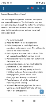

Did you ever fix your primer knob and test that it's pumping fuel?
Yes, I got the knob and installed i, I don’t know if it pumped fuel, but I took out the brand new plugs after I pull so many times, it has the fuel on the tip of plugs, and the water bucket has a lot of oil/fuel in it.
38,802
Answers needed.-----Does spark jump a gap of 3/8" on a testing device ?----Testing device can easily be made at home.-----Are you familiar with how the manual primer on the motor works ?----Does that primer pump fuel into the motor?----Perhaps test the primer valve.
