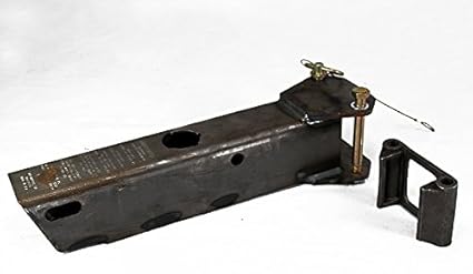

Only the tongue is bent. Do you guys think this would work (see link)? It looks short in the photo. Thanks!

That looks a lot shorter than yours. If your boat doesn't sit too high on the trailer and the pin spacing is the same it should work.

Is what you're replacing 3x4 like the one at Amazon, it's hard to tell 100% in pics. Next question is if the swing assembly will match up to what you have, it's welded and the piece for the other side is also weld on. The pic of your damaged one appears to be very similar but the amazon write up doesn't indicate a length so that's a concern.
