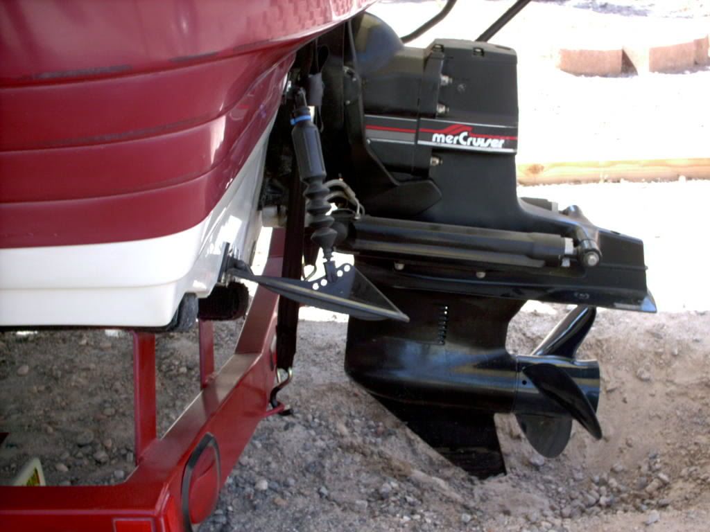

Ok, finally got up the ca-who-na's, to drill holes in the boat below the waterline.
This is what they look like. Basically the only place I could mount them because of a custom swim platform.

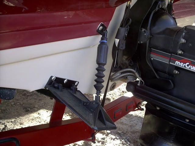

Now. The problem I'm having is where the actuator is mounted on the top.
I can only go about 23 degree's down on that ridge of the boat.
Now if I were to go down one ridge on the boat to mount the top of the actuator, it would put me at 30 degree's at the shallowest position.
I chose the lesser of two evils.
My question is.....Do they make an extention for the actuator so I can set the tab in the center hole at the 25 degree's? I'm guessing I need about a good 2 inches longer of total length.
Thanks all.

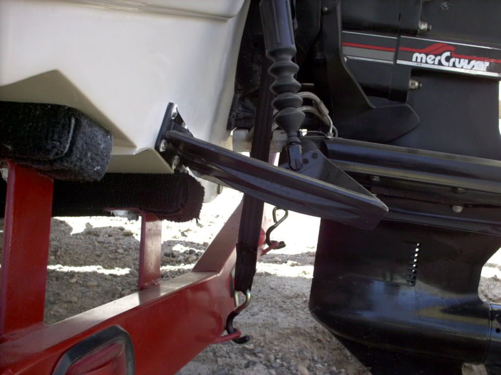

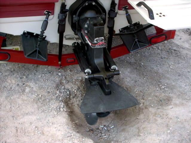

Remove that fin off of the drive, you do not want both on there.

Remove the hydrofoil!

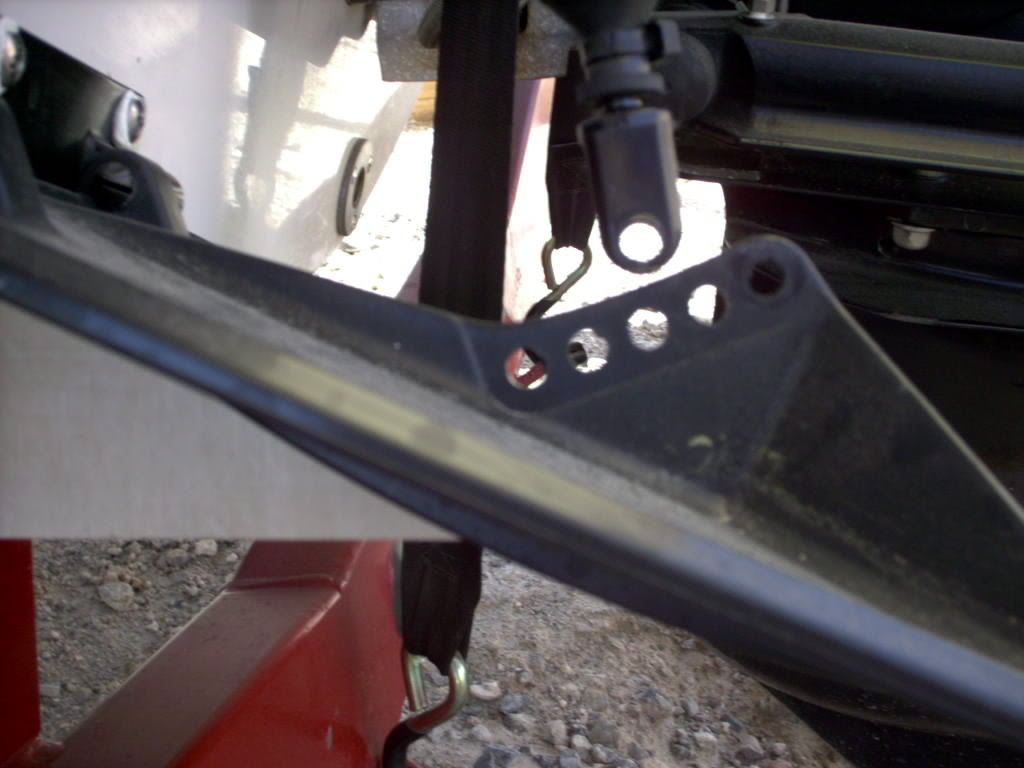

I would like to know why you put the actuator in hole #5 which is the stiffest position. This will not make the tabs deploy more. It only increases the pressure. Also, if you can call or email me I will send you some additional hardware which will make it easier to adjust the tabs (pressure).

Anyway, I need about 3/4" more of length on the actuator to get the 25* for the center hole. The second pic is to show that I did in fact remove the hydrofoil.
