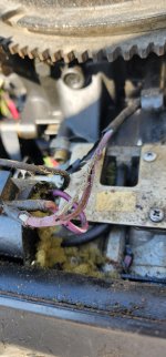

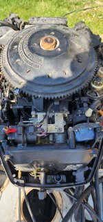

I have an Exposed wire under the hood. Everything seems to operate but this wire is nearly gone.
What is it for?

Feeds 12 volts to electric primer valve.----Operates when you push the key in while cranking for cold starting.

Looks like critters been in there too, like where did the wee bits of foam come from?
38,481
The wee bits of foam must be cleaned up.----If they get into / stick in the reed valves there may be issues.
