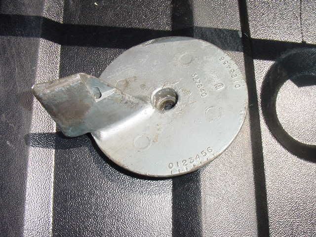

The guy i'm getting the lower from sent me some pics and i noticed the trim tab had a hole,Is this a pickup for the speedo? If it is how does it work? 175 Johnson,1981 model.

On my 150 the spedo pickup is at the front of the gearcase. About 2 inches above the propshaft centerline. Not sure about the hole in the trim tab.

I donj't recall the purpose of the hole, but don't see how it could serve as a pitot, which has to be facing forward in undesturbed water. The trim tab, being behind the prop is anything else but undesturbed water.

Thats what i was thinking,the prop turbulence would mess that up. The old lower was so eaten away i can't tell by it..Guess i'll look over the new one when i get it.. Waiting on my manual also..

That hole in the torque tab is to add water to the exhaust to cool the hub in the prop.
OK...I understand that,Thanks Dhadley
