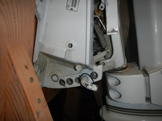

I've attached pictures, from the looks of my bracket on the starboard side, it matches the diagram, but am missing a hole on the port side of bracket. Can you confirm I'm good to go please.
Thanks again for the assist, and quick reply!
Starboard 1979 Johnson 70 hp bracket
port 1979 Johnson 70 hp bracket

Re: Johnson Trim tilt question
I see three (3) PTT mounting holes on both transom brackets. If you're speaking of the forth (4th) hole on the starboard bracket, that is an access hole to allow you to loosen/tighten the PTT manual release valve.
Notice I had three arrows there, not four. :)
Bottom line = Good to go!

Thanks for the confirmation Joe!
I saw the three arrows, but was unsure when I saw different configuration w/o 4th hole on the port side of bracket. Going to pick up TT at three this afternoon.
