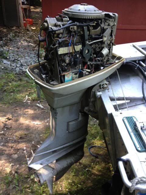

Hey folks,
I'm brand new here but I understand that this is the place to be for figuring out my issues and networking with fellow boaters. I purchased a 16' Aroliner this Spring with a '69 55 Evinrude on it. The old timer who I bought the boat from had no problems with the motor for over 15 years then on his last outing he lost the fuel pump (so he thought). The boat came to me with the new pump in the box. I'm pretty sure the problem was more that all of the fuel lines were sprinklers. I replaced them all and new plugs gapped to .028; checked the points and gave them a quick touch up and checked the gap which looked good (.010 I think). So onto my issue(s). The motor is fairly hard to start (electric) but I could blame that on my technique. Once running it is severely underpowered. The first time I had it out it ran strong for about 10 minutes then dropped power by 50%, I could barely limp it back to the boat launch. I discovered a few wires that were seriously corroded so I repaired them. I then took the boat out the other day again and just limped it around at a putt while the throttle was wide open. Brought it back in and the starter would just click even on my spare battery. At this point I also noticed that the flywheel was extremely hot to the touch. I haven't started it since. The plugs are very gassy with #1 being the worst.
Are there some easy multi meter test that I can perform to try and eliminate some of the issues? Or is this motor even worth wasting more time and money on? I've yet to get a manual since I'm not sure which direction I will go from here.
Sorry about the long first post, I just needed to get the details out there.
Thanks in advance.

There is a plate on the port transom bracket with the model & serial number. What is the model number?

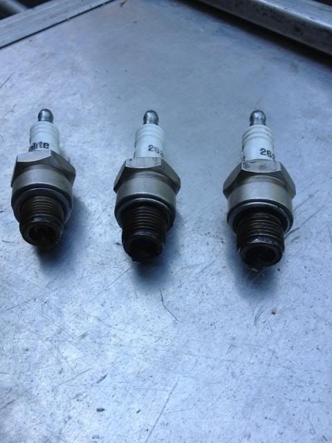

Spark plugs should be Champion L77JC4 or QL77JC4 plugs, gaped at .030.
Carburetors foul when sitting and usually require cleaning and rebuilding somewhat. At the least, manually clean the high speed jets that are located in a horizontal position in the bottom center of the float chamber... way in back of the 7/16" drain plug bolt.

Alright, after torching the fuel soaked plugs I made an attempt to follow these instructions a little closer. I set all of the s/s needles to 1 1/2 turns out from a gentle seat. I could start the motor but only in the full throttle start position. I started with the center carb and began to slowly turn the needle in as instructed and the rpm climbed dramatically and only began to stumble when fully seated or maybe an 1/8 turn from closed.
Normal?

I started with the center carb and began to slowly turn the needle in as instructed and the rpm climbed dramatically and only began to stumble when fully seated or maybe an 1/8 turn from closed.Normal?
No, that's not normal. Sounds like you did not lower the rpms as per my instructions as the rpms increased? The following copy/paste from my above reply.
"Start engine and set the rpms to where it just stays running. In segments of 1/8 turns, start to turn the S/S needle valve in. Wait a few seconds for the engine to respond. As you turn the valve in, the rpms will increase. Lower the rpms again to where the engine will just stay running."
That's a touchy engine to adjust even when new from day one, hence my reply with precise instructions.

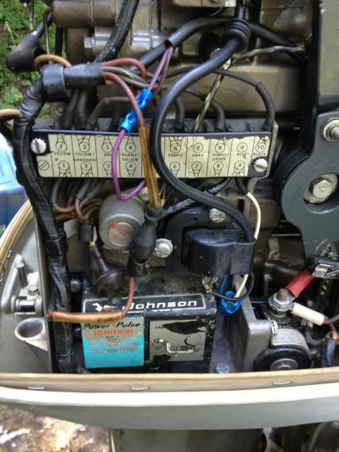

As soon as you get this motor running right, SELL IT!! The electronics on these are an outboard mechanic's worst nightmare. Then I would get an 70 a couple years newer. The electronics are much improved and are less likely to drive you and the mechanics nuts. The 55's are good motors, mechanically, but electronically, they are a nightmare. When this motor was built, a lot of revolutionary changes were being born, in the outboard world. A newer sleeker look and sophisticated electronics. The old conventional type of ignition sytems started fading out in larger outboards, during this time and the newer types became more costly to replace. If you do have to replace anything electronically, shop very carefully, or one single piece can easily surpass the value of the whole outboard.
82rude
May 8, 2012
4,082
Re: Keep it or Ditch it
what you have is a good motor with elect nightmare .zeph is right .that being said it is also a loop charged 55 hp that punches way over its weight class.evinrude claimed that they droped the 65 because the 55 looper could fill its hp class also.see the " old omc site" on line for lots of cool info about omc engines from days gone by.i had the Johnson version of that motor and it was one of the best motors I ever ran.my brother had yours and it was horrible electronically wise.hope you got the good one made on wed instead of 5 to 5 on Friday,lol.

Hah, that's funny you would mention which shift it was built on at the plant. We make that reference all the time with our old cars and it's usually true.
I was actually feeling like it was a fueling issue more than electrical but I'm a bit of a newbie when it comes to outboards so please feel free to boss me around. This particular motor was built as a hybrid of the best parts some hot shot outboard guy built back in the day so it's all Johnson/Evinrude intermingled. If there were some simple tests I could perform to determine if it was my electrical system or fuel system or both giving me problems then I would have somewhere to start but I'm a bit stumped right now.

Do you have a known "good" compression tester. Those motors new would put out 160+psi. Given that the #'s are so close, it may simply be gauge/testing technique.
Does the motor turn over fairly quickly? This is important for testing and for starting.
Check it with an inductive tach if you have one.
For compression, remove all plugs and test one at a time. You must ground the spark plug leads. Good time to check spark in each cylinder.
Did the motor overheat? did you feel the head temp? What do the new plugs look like?
That motor may appear to be running ok at idle, when in fact it may be only running on 2 cylinders. A cylinder drop test would determine which are firing.
