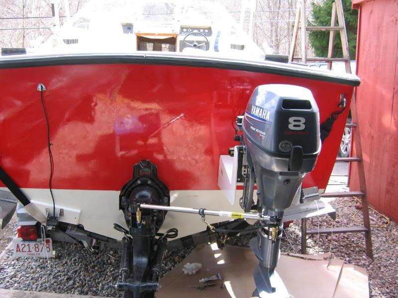

a simple metal link with two rod ends is easy to tie it to your outdrive. they do it all the time.

The picture in post 8 shows a store-bought steering bracket. I rigged my own setup on my last I/O. I made the rod using a SS threaded rod. QD ball joints were added to the ends. I made a SS bracket and bolted it to the OB's lower cowl. A second bracket was attached to the outdrive using one of the top 4 bolts. In this way the two ball sockets were quite a bit higher and easy to reach from inside the boat.
