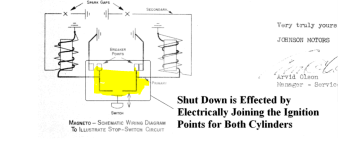

38,491
The idea is clear.----The 79 model 85 does not have breaker points.------The kill switch connects the 2 " M " terminals to stop the motor.
Crosbyman
Nov 5, 2006
5,680
I understood that ...we are dealing with a concept and now a "modern" solution of shorting 2 M wires
M's that formerly went into the Magneto.
38,491
The 79 model 85 HPmotor has a magneto system.---It uses sensors and no breaker points.
