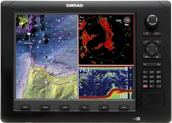

Understood. Most (probably all the current stuff) GPS chart plotters have the capability of measuring depth using SONAR. Many can also display weather RADAR data, AIS data, and onboard RADAR data. They can also display engine data, video camera output, and any other NMEA2000 data.
Note the depth data on the chart to the left and the depth data on the SONAR display in the lower right. That lower right depth data is measured, not inferred.
I can connect a transducer to my ancient Standard Horizon chart plotter and measure/display depth quite easily, while also finding/dipslaying fish.
