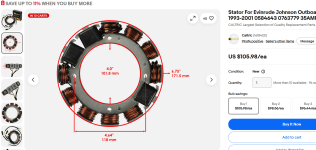

Found this one. Almost big enough for go around the crank flange.
Stator For Evinrude Johnson Outboard 200HP 6Cyl 1993-2001 0584643 0763779 35AMP Fits Following Evinrude Johnson Models: 200HP 6Cyl 1993-2001 Order Includes: 1 x Stator : 0584643 0763779 Outer Diameter : 171.5mm Inner Diameter : 101.8mm Width : 44mm Mounting Hole Distance : 118mm
