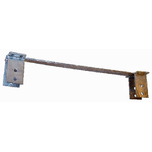

Yeah, my thoughts too, every pic online they're welded straight to the frame. These are welded to a piece of 3" Flat bar and the fender U-bolts are securing the assy. I was hoping someone has seen this setup.

Ayuh,...... Welcome Aboard,...... That's a 'ell of a cob job,.....
Double eyed springs need a shackle on one end to be able to flex,....
Looks like it was bolted solid,.....
You need something like dingbat linked too, as well as new springs,....
Those brackets, with slipper springs would work,....
Or double eyed springs, with rear shackles,....

That undercarriage setup is actually quite common and desireable since it allows fore and aft adjustment of the axle so proper tongue weight can be achieved without repositioning the boat, support sturcture, and winch post. That said, the undercarriage is shot on this trailer so its not just springs you need. New spring hangers, springs, U-bolts, plates etc all need replacing. Parts are relatively inexpensive in the grand scheme but the spring hangers and probably the angle they are welded to should be replaced as well. And whether all of that is worth it depends on the overall condition of the frame. Everything you need is generally available and any farm equipment supply store. Northern Tool is another source. I think even Harbor Freight carries this stuff. But of course, shop right here on I-Boats.
