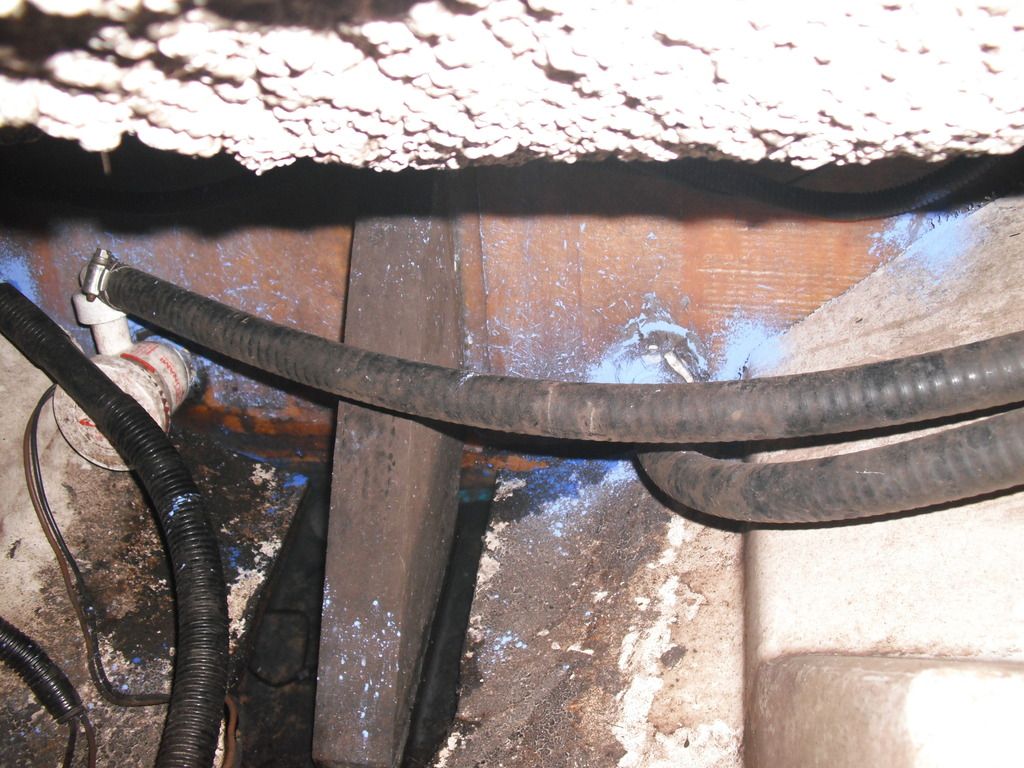

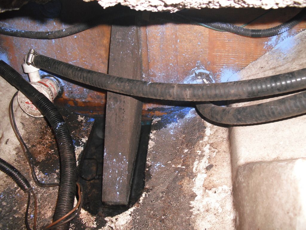

Bayou Dave
Dec 13, 2012
1,780
Looks like I may have found where it is leaking. Before going to the ramp I made sure the bilge was dry and put some chalk dust where I could. (Thanks Patfromny)
It looks like the leak is around the drain plug. You can see in the photos where the chalk dust is wet and where it is still dry. I only put the boat in the water and tied up to the dock.
kcassells
Oct 16, 2012
8,738
Awesome...Patfromny nailed it! On with a check in regards to the transom. It's got to be a relief to find the ghost leak.
Bayou Dave
Dec 13, 2012
1,780
I should not have to check the transom. According to Larson the transom is made of composite material made by Polycast Specialties. I will take off the screws to the garboard drain and see what I find.
