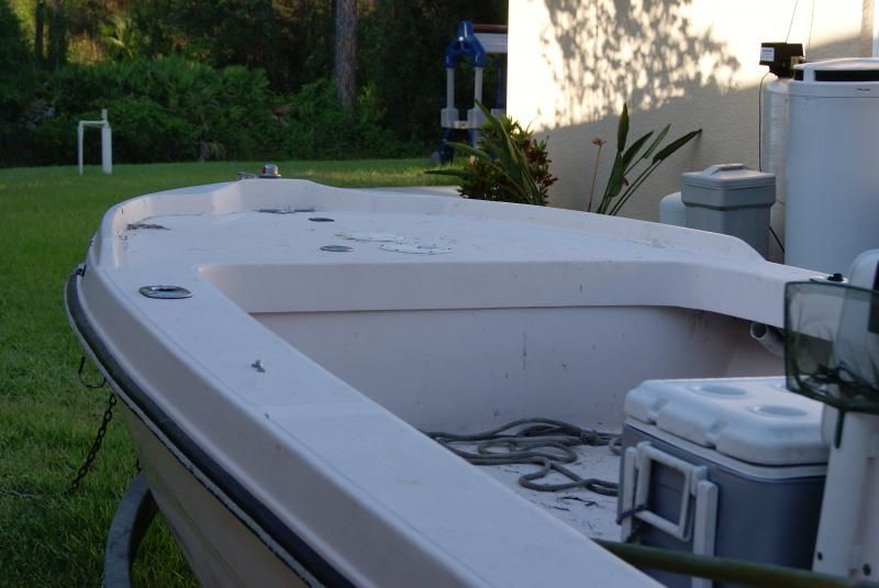

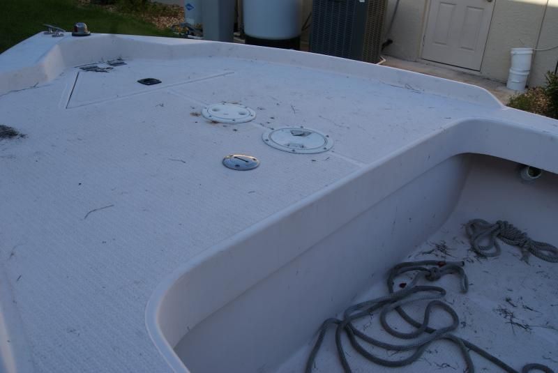

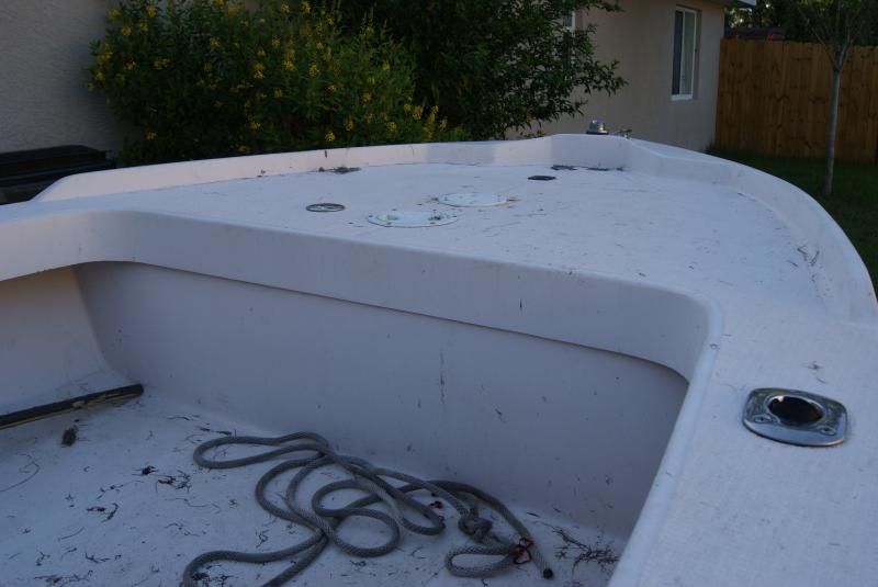

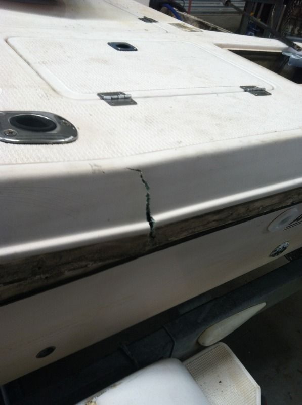

Yeah I suppose some pictures would help.
Here it is... 89' Action Craft Bayrunner... filthy after a night of throwing the cast net.
The gas tank is directly under the filler cap... and take up pretty much all of the bow rear of the anchor compartment.
I think this is what I've read as a "shoebox type" top cap... So from what I can tell it should come off pretty easy.

Aren't those inspection holes with the covers on the bow??
Can you reach anything below deck through those??

Lol, I wish. They're idiot holes... where the idiot previous owner mounted a bass fishing seat. One is just big enough to change the fuel hose and see a 1 square foot section of the top of the tank.

I wouldn't remove the cap......personally, I would cut the glass large enough to remove & replace the tank, then glass it back in. Would just have to glass the cut out section back in, and a bit of gel coat. Perhaps get creative and make an access hatch for future accessibility.
Before you tear into things, keep in mind the leak is most likely the filler hose, or where the fuel line comes off the tank. If you can access those two places with a much smaller access hole, you can then buy a hatch on the web, to install where you cut the opening. That would be the easiest and fastest. Check out hatch sizes and prices......iBoats has them......and decide what size you want to shoot for. (Cut a little smaller, then enlarge to the needed size.....) I would suggest an access hole about 6 inches wide, and 9" front-to-back, right next to that filler cap. Center it on the deck, right about where the old seat mounts are. That should give you access to all the fuel lines.
If it's the tank itself leaking......well, either pull the cap or cut an opening and plan on re-glassing it together.

Note: The vertical bulkhead under the bow. After further looking at your pics, if you have to remove the tank, I would cut that bulkhead out, leaving the top deck the way it is. The tank should slide right out through there. You can either glass the bulkhead back in, or preferably make your own with an access panel in it for inspection. Should be just the bottom and the two sides to cut.

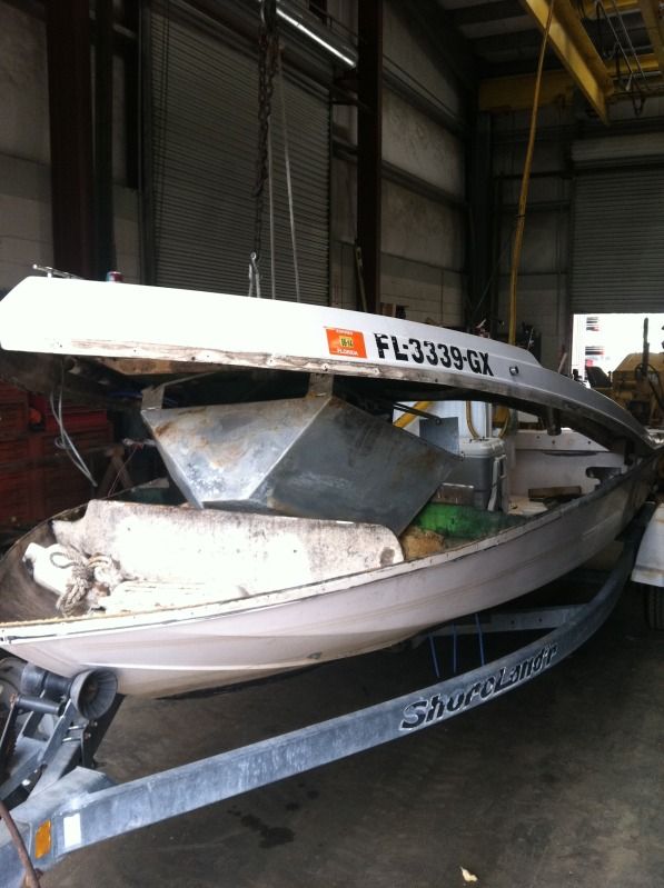

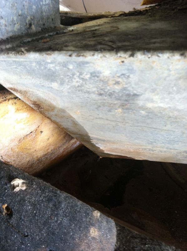

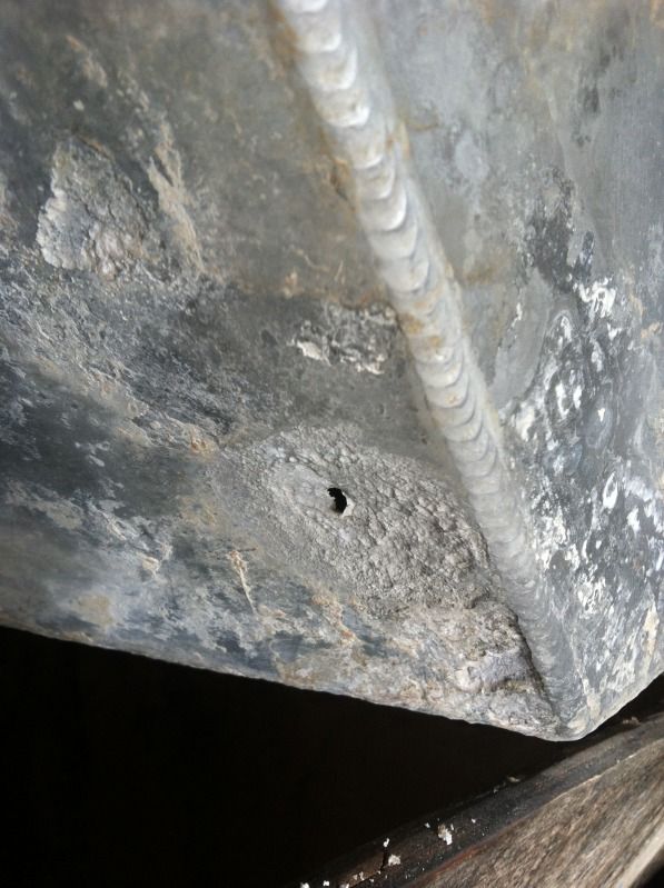

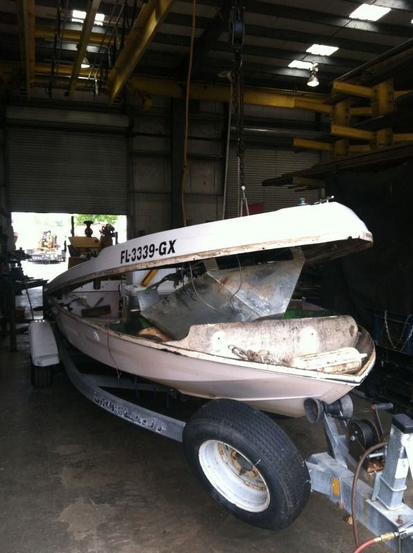

Got the tank out today... cracked the cap in the process. :facepalm:
Tank was totally blown out... holes and pitting everywhere.
Ordered a new plastic tank that I *THINK* will fit. We'll see.
