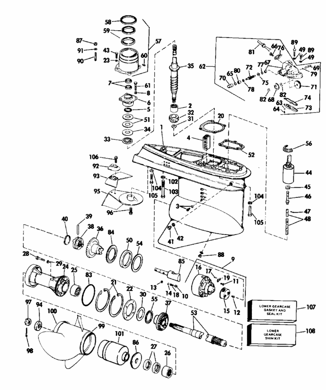

Re: Leaky OMC Stringer Drive
Sikz3,
Below should be a Lower from a 1980 Series 400 Lower. Tell me where this Weep Hole is?
sikz3
Mar 25, 2006
244
on the underside of the "cavitation like" plate right above and bow side of the upper fill plug. (41,42)
Looks like you should pressure test both Upper and Lower. My money is with the Upper Gearcase.
