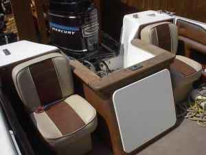

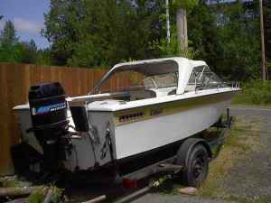

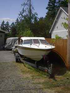

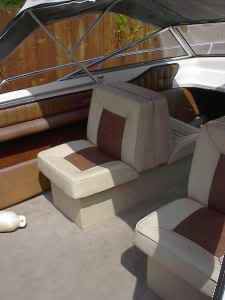

Here are some pictures of the boat:

It doesn't look like the typical Ranger boat. I guess I am curious if I should move on this thing or not, and if my 85 merc would be able to get this boat on a decent plane. The price seems nice.
I also wonder about the fuel tank leaking. It seems odd that the tank couldn't handle modern gas. Could this cause other problems with the fiberglass?

I'd be highly suspicious of the tank. Ethanol is NOT going to make it spring a leak unless it's a hose fitting. How does he KNOW the transom is solid? What has he done to ensure it? 35 year old boats MUST be very well cared for to NOT have some major issues. My boat was 50 yrs old BUT was Barn Stored for ALL of it's life and I could trace her entire history. Your motor would power the boat adequately. Just make sure transom, deck and all other structural issues are AS ADVERTISED!!!!!

That's a nice hull that's worth fixing up. Your 85 should push it fine. Ethanol deteriorates fiberglass tanks so that's probably what happened. I'd be tryin' to get it for $500 or less though. It doesn't really have much value with a non-running motor.
