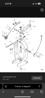

This one might be an insurance claim as often the engine may have to come out and depending on how transom was cut out, the transom assembly might have to come off as well.
You’ll have to remove the nut and washer item number 15 and 17 or use a cutout plate at the outside transom to gain access to the nut from JR Marine, https://jrmarine.com/instructions.htm

Looking at the arm, it would appear there is a lot of corrosion in there indicating the steering pin / seal are no good also, allowing water to seep by, rotting out the pin and steering arm. Common Bravo problem.
Transom assy should be rebuilt / replaced depending on condition.
