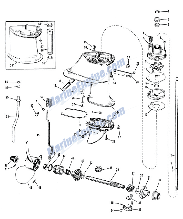

The other week someone posted a lower unit diagram for a 64 9.5. Can't find it

So I got it put back together the way it should and the shift linkage leaks, friend of mine pressed it and lathed it so i can press it back in. Crappy design in my opinion

I had a machinest friend of mine squish the bronze insert so it wouldn't be loose where it's captured around the shift shaft. What is the other solution for this?

just opinion...
if the brass collar is loose sqishing it seems a bad solution.
shouldn't be to hard to find a thicker brass rod...... drilled out to the proper size for the shift rod and turned to reduce its diameter a few thousands extra for a better hold in the GC
your machinist friend should be able to do that for you ....being a machinist
maybe welding just a touch of regular solder to beef it up will allow a better fit

The o-ring inside can be replaced in 3 ways without damage to housing.----Pull bushing out after running a 5/16-NC tap in for 3 threads.-----Using the factory tool to drive it out ( I have 4 of them )----Or believe it or not you can remove / replace o-ring without removing the bushing.----And remember this was 1950's design and factory methods of the time.----A lot easier to maintain than some newer set-ups

When I took it to an Evinrude Tech that worked at the factory and showed him how loose the Bushing was he said that it's common that the aluminum through time will corrode and make the whole bigger. He's been working on them for around 55 years. He suggested squishing it as a solution.
