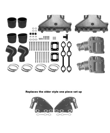

So a local mechanic is telling me I need a new manifolds and risers kit for my 1999 Merc 4.3 (2bbl). He says mine have the infamous "foghorn" style which Mercruiser used for only 4 years, due to problems from bad design? How much should I be looking at to replace basically my entire exhaust system (I guess)?
Geek, with the price he's telling me, seems I could just buy a used engine and drop it in...

The Barr Marine aftermarket conversion kit is $1200 plus labor. A new engine by the time you’re done if you’re paying someone else will be about $5000. Those were a bad design they couldn’t get consistent wall thickness so there were a lot of failures (water intrusion).
My OMC also had the one piece units while I never had problems with them because I’m in salt water you have to replace them every 5-7 years or you’ll have water intrusion eventually.
I made up my own conversion using Barr Marine aftermarket manifolds and elbows and Volvo Penta exhaust pipes and hoses. So my engine is on its 4th exhaust system don’t feel bad about having to replace it once.

Thanks for your reply!! Do you have a link to that kit? I went to the Barr Marine site, but can't seem to find it. Is the kit complete? What else might I need?

The kit I posted above uses the older style wet exhaust joint, but enables you to make the conversion without changing the Y pipe (which requires pulling the engine). Not sure if its possible to do the conversion with dry joint manifolds & elbows.
Yes it is.
Instead of the kit for the 2 piece wet joints, use the parts I list in my exhaust shutter thread for 7° elbows.
What the heck, here's a list of parts required.
V6 Dry-joint Manifolds: –864612T01
Manifold gasket: 27-99757
7° dry-joint Exhaust elbow: –864309T02
Elbow gasket (for raw water cooled): 27-864850A02
V6 Intermediate elbow (with NO riser): -14478T01
Rubber tubes.
Upper: 32-44348001
Lower: 32-14358001
Hose clamps: 54-815504372 (you'll need 8 per side)

So anyone have a ballpark guess on what it should cost to have this kit installed (basically replacing my old manifolds/risers with this new stuff) - parts, hours of labor, etc.? Thanks!
achris
More fish than mountain goat
May 19, 2004
27,468
Using genuine Merc parts, you're looking at around $1100 per side for the parts. Labour to remove the old and install the new would be, depending on access, around 2 hours per side, if everything goes well. If the Merc price tag balks you, then you could try one of the aftermarket conversion kits, but I can only find wet-joint conversion kits, and if you're going to ditch the batwings, put dry-joints on....
