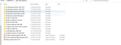

Here is the cooling flow diagram from Manual 3 which covers All engines & drives 1978 -1984
And here is from manual #8 which covers the newer models with the 4" exchanger.
Mar 27, 2010
3,008
The older manual 3 goes into cleaning the heat exchanger, says it should be done every two years.
and also mentions the 4" exchanger on the following page. You should be good as far as connections go, you may have to fabricate two new brackets to accommodate the larger diameter if the 4" doesn't come with them. When you see MIE, that's an inboard without an outdrive, we have MCM version.
