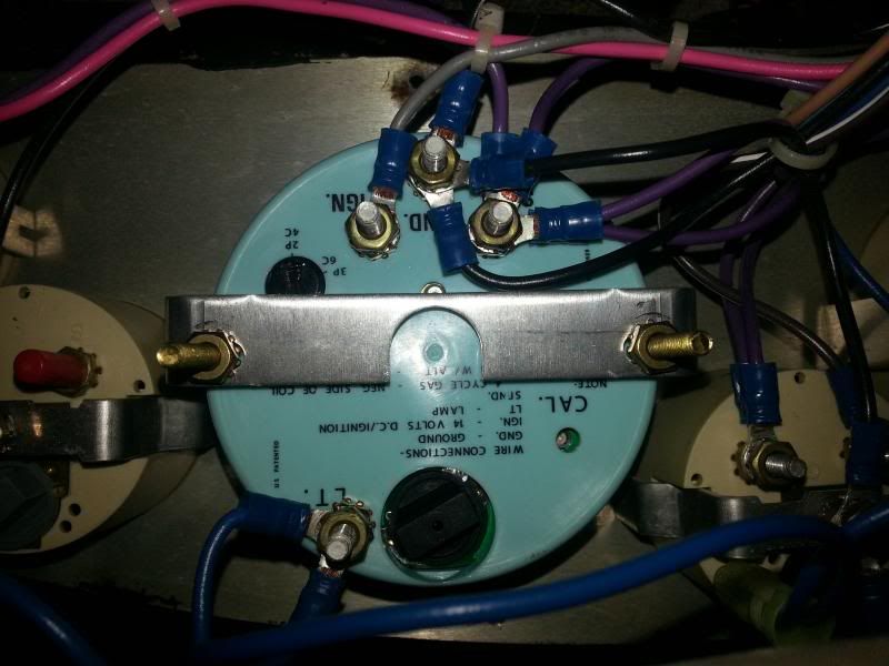

Pulled the dash to check out the tach. Everything looks nice and tight with no corrosion. I also gave the tach's engine selector a few spins as I have seen that suggested quite a few times.
I was quite surprised at how many wires was coming off the back of the tach. I was only expecting 4 or so.
Might just go bight the bullet and pick up a tach.

Went and snagged a new tach from Bass Pro. Installed, and now the boat won't start. I am pretty sure the tach is working, when I turn the key on it resets to 0 and while turning the motor over the needle is jumping with the turns of the motor.
My plugs are quite soaked in fuel, so I don't think fuel is the issue. I am thinking spark, could the tach prevent the boat from starting in anyway?
I had a single grey wire, 4 blacks, and 4 purples. The purples are going to the post labeled sensor, the blacks are going to the post labeled grn, and the grey is going to post engine.

Yep sure enough, when I took the old tach out I just looked at what wires were hooked up to what post. I never thought to compare the actual speedo's themselves, the sender post and ignition post were switched. I went ahead and made the change so now the gray wire is on the sender and the purple's are on the ignition. She still isn't firing. All I smell is fuel, so I am thinking she is just real flooded. Going to give it a try tomarrow and if need be replace the plugs. I guess its not my day, one step forward and 3 back! Appreciate the help guys.

I just keep striking out and making things worse. Went to mess with the boat a bit this afternoon to see if it was no longer flooded. Hooked it up to the muffs and started to turn her over, as I was doing this I heard a click and all went dead. Peaked my head under the dash at the fuses and my 10a ignition fuse was blown. Put a new one in, soon as I turn the key, blows the fuse. Obviously this is some type of short, I looked over the rpm gauge again and all seemed well.
I am stumped and frustrated at this point. Maybe I should try removing the new rpm gauge and putting the old one in place. I amm 99.9% positive I have the gauge hooked up right. Purple being the ignition, grey being the sender and black being ground. When I had the send and ignition wire's crossed last night could that have killed the gauge, and now that I have it hooked up right, its shorting out?
If I understand things correctly, it is going to be a number of things.
1. Gauges
2. Coil
3. Alternator
4. Choke
I feel this diagram confirms that I have the guage hooked up correctly.
http://stingrayboats.com/products/pdf/wiring/180RS_wiring.pdf
I did attempt to disconnect the choke already without any luck. Does this sound like the correct direction to go in?

What is the make and model of the new gauge you bought?
if your plugs are "soaked" with fuel, then I am guessing it is getting flooded for some reason. especially if you are smelling fuel.
put the old gauge back on and see if the boat starts up. if it does, then there might be some type of wiring in that gauge that is not compatible with your wiring.
One thing you can do is take the #1 cylinder spark plug out of the engine. Plug the spark plug into the spark plug wire and turn the key. you should clearly see a good spark and hear the clicking sound of the spark. If there is not spark, remove the new gauge and install the old gauge and turn the key again. Does it spark with the old gauge installed? If not then take the coil spark wire off the distributor cap and put it next to a ground or insert a spark plug in the end of the wire and turn the key and check for spark.
Also, my 3.0L engine has a red button back in the engine bay and it says "push to reset". try to push that and see if that breaker just flipped and needs to be reset.

Here is what I have done so far.
1. Disconnect all wiring from tach and test turning key to on
- The 10a ignition fuse no longer blows
2. Returned "New" tach for another new tach
- Still same issue, blow 10a ignition fuse
3. Installed original tach
4. Attempted to start with tach disconnected
- Wouldn't fire, plugs soaked
At this point I am stumped, how I managed to install a gauge and really mess something up.
I am not sure if it will even work, but I tried turning it over with the gauge disconnected and it wouldn't start either. I checked my breaker but I am unable to push it, should I be able to push it even if it doesn't need a reset?
UPDATE
Just tested for spark. I don't see any spark with the gauge disconnected, or just the sender/ground wires connected.
