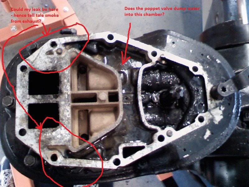

Have a look at the attached picture - couple of questions on it.
I'm wondering now if this is really a major issue - if its cooling OK and just leaking exhaust gas from the 2 x square exhaust chambers shown on the picture into the pisser outlet no harms being done is it?
I could 'T' of the stat output with a fine bore hose and use that as the (in effect 2nd) tell tale and job done? - I wouldnt block off the first and would need to leave it venting overboard so as not to 'gas' the motor if it was left open in the case.
I've spent so much time and money on this motor in the last few months of owning it (carbs all rebuilt, impellar, stats, rectifier, control box) I can't justify pulling the power head as well can I - surely this is a major job?
Thanks
Jim

The poppet valves dumps into that little triangle hole bottom center of your pic. The tell tale comes off the t-stat down tube that dumps into the exhaust plate and cools the exhuast at the idle relief port. If there's no water in the down tube from the t-stat then exhaust gas will come out the tell tale. Take the down tube off of the head at the t-stat and see if anything comes out of the t-stat. If not, clean the t-stat weep hole out. Check the down tube for blockage also.

Re: Merc v6 150 - Pisser Smoking and no water - video enclosed
perhaps I should pull the pipe off the poppet and run it up again?
Yes as it feeds water to adapter plate.
This is correct for later models, but this one has starboard t-stat housing feeding bypass on poppet valve. The tattle tale comes off adapter plate for this model. (see picture,item c) The early 150's, 175's had this as did the 225 but it used a idle restriction plate behind poppet.
