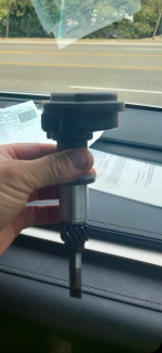

Hi,
Please help us identify the parts in the pictures.
We have gone to the official Mericruiser dealer but they told us these are aftermarket parts and they couldn’t identify what they are.
Issue: we washed the engine and it lost almost all of the spark and would not start. We think it’s ignition wiring trouble.

I’ve never actually seen one of those apart so I’m not 100% sure but it appears to be the DIS ignition, which never works right. Parts are NLA. It was used for a very short time so your mechanic might not even be familiar with it.
Put a Delco EST distributor in it and go boating.
