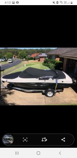

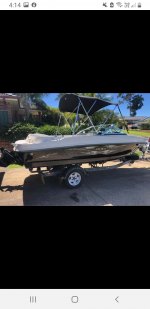

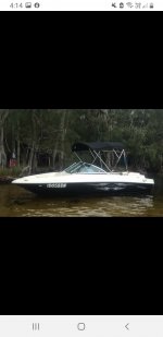

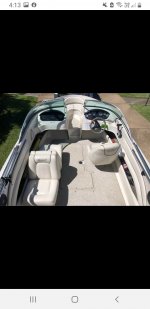

I am looking at purchasing a 2008 Searay sport 175 with a Mercruiser 3.0 (Alpha 1 leg). I've read some positive posts about this motor as they're economical with enough performace to cruise at 75kmh no problem. However I am a little sceptical as this is my first inboard. Some say as long as they're maintained and serviced then there won't be an issue. Others say the manifolds need replacing often which is costly. Also the legs aren't that great? I am confused and don't know what to buy. I want something with good performance however economical and as less cost to maintain as possible. Who doesn't! Should I stick to looking for an outboard or is this motor going to serve me well? Thanks all

I should mention it has 257 hours. Intake manifold replaced at 200. Serviced at 240. Apparently serviced every year before summer and flushed regularly with fluids topped up every few runs. Is this enough to substain a healthy and reliable motor for myself if I were to purchase this boat?
50,407
first, welcome aboard
second, any used boat is only as good as the maintenance it recieved
the 3.0 is the entry level motor. it wont do 75kph unless your towing it. WOT speed in a light hull may be in the 65kph range. cruise would be in the 45-50kph range.
the A1G2 outdrive is good for up to 300hp (5.7 V8's) not sure where you got the comment in post #1
if you want low cost of maintenance in a boat, get a row boat
if you want economy in a boat, get a row boat powered by slaves like the vikings did or add a sail.
the fact that the intake was replace at 200 hours tells me that something was amiss in the boats past. I personally would walk away from it. also, with only 257 hours, thats averaging less than 20 hours per year. If this is a salt water boat that was flushed regularly (after every use), the intake should have lasted longer. it most likely sat for a while with salt water in it.
