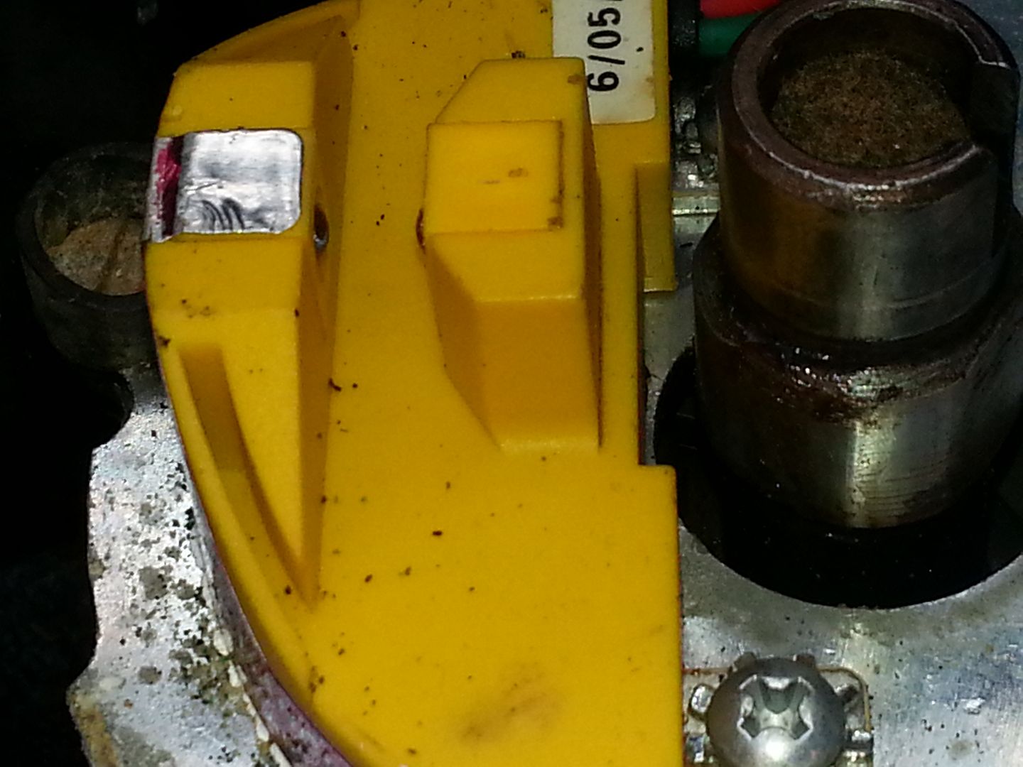

Well problem solved. I was given the wrong rotor. We new it looked different but its contacts was right and so was the location. But this electronic ignition uses the rotor for the trigger. How stupid. Now to get a rotor when i tune it. Ill need to contact mallory.
This is a close up. And what got me thinking. See no trigger point.

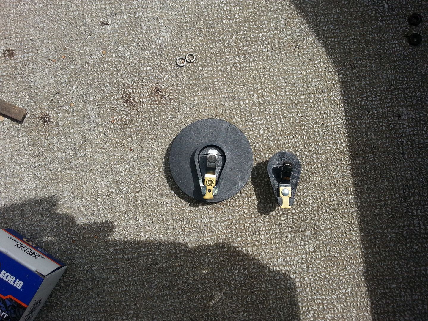

This is the old and the new rotor Old on the right.

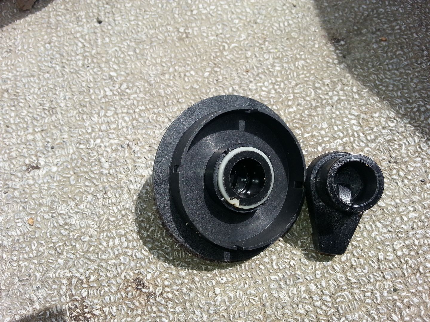

This is the under side. Notice the router has a 4 section plastic fin that goes around the bottom. This is the trigger
So if you need to tune these up dont believe the parts man. That is not a radio interferance shield. LOL! And I will try to locate a new one now.
