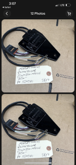

I've got a Mercruiser 4.3 LX in a 1989 Baja but can't get it to fire. Replaced the engine and it worked great. Then I rebuilt the outdrive and it's not working. It turns and turns, but nothing. I did the coil test and replaced the module inside the new distributor. Could it be the ignition amplifier (triangular part that says Thunderbolt IV and v6-14)? Is there a way to bypass this just to get it to fire to determine if that's the part?

Yea it's an Alpha 1. The interrupter is on the drive shifter (forward/reverse right?) but since the starter turns, id assume that isn't messed up, right? When I'm in forward gear, it won't spin the starter - in neutral it will. Could the part in the photo attached here be causing the issue? Maybe it's bad?
Yes, but so could every other part in the ignition system. If you test then it can be narrowed down, otherwise buying and throwing parts at the problem may fix it, but may also add more problems
