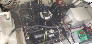

I've got a 2010 Bayliner 245. 5.0l Mercruiser TKS B3 leg.
When starting the boat (even if its only been sitting for 24 hours) it takes quite a while to get up to operating temp (170-180). During that time sitting in the slip I have to keep the choke in or else the engine will stall. It will usually take 20 mins + before I can actually put it in neutral and it will idle without dying.
Also during this time I get a very rich fuel/exhaust smell with some smoke. The smoke goes away once in neutral with no chokany advice would be appreciated and a picture of engine below for reference!
Thank you in advance!
