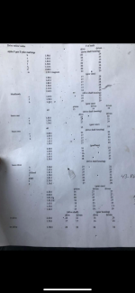

Not finding where a 1.81 tooth count for a diesel is different then the standard. Even the X drives are 29/27
With 22 props the slip is real bad

What ratio do you think I need for the boat and engine?
