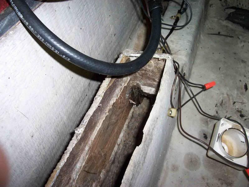

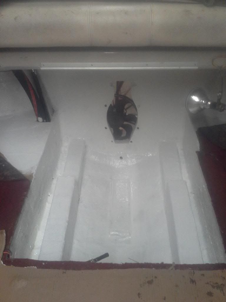

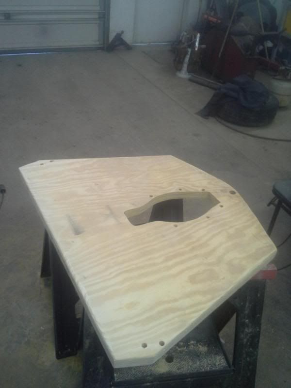

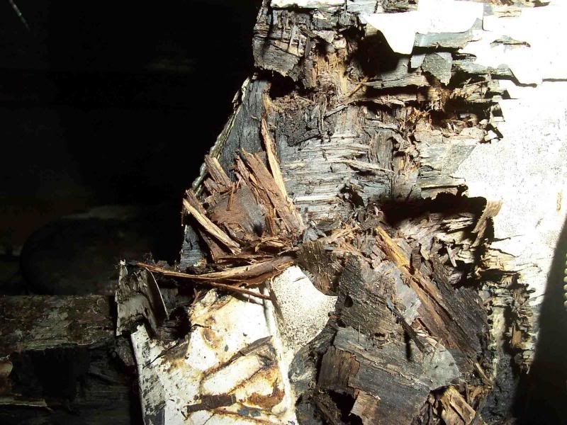

Where is the crack, is it leaking fluid? I have an 87 imperial and i had a crack in my lower as well, it was in a small cavity in the front that did not breach the oil, so make sure you pressure check it to see if its an issue, of course if it is leaking you can skip that part. I still had to get a new one for other reasons unfortunately. Look for your transom assembly number and should help to id all the fact about the out drive so you can get a new lower, a good one is going to run more like 400-800 used and 1200 new. If you have a local boat salvage yard you can look around there, mine was pressure checked and had a new impeller so this factors into the cost. i think i paid 450 for mine and installed it myself. love to see pictures of the boat, i rebuilt mine form the hull up......not a lot of imperials out there. Seam like good boats, except for the rotting...........which i have more than fixed.

Rot???? I don't know what your talking about LOL
