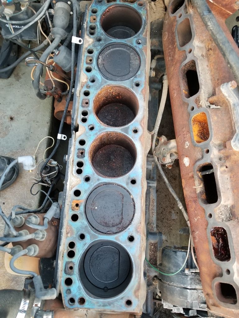

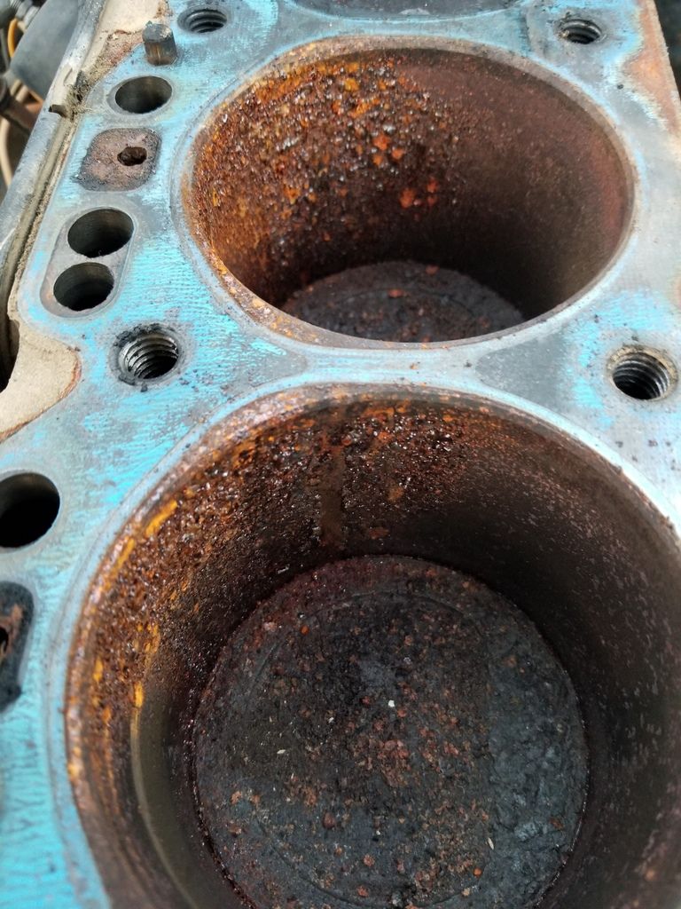

Hello,
I've just taken the head off of a mercruiser GM 165 that was seized and am posting pics of the middle two cylinders. They are pretty rusted and pitted. My question, as a very inexperienced shade tree mechanic, is "Can this be saved, or is it too far gone?
Thanks,
Gary
PS - what's the best way to rotate this engine manually? doesn't seem to be an obvious and easy way to do it except with the starter...

mickyryan
Apr 18, 2016
4,216
totally fixable!
I have seen worse that is what happens when a boat sits for too long try some emory cloth first to knock off the high rust then vac out , fill cylinder with pb blaster let sit for awhile , i use a mix of pb and marvel mystery oil, then take and once a day try to move the crank, eventually it should break free then once you can spin the crank hone the walls with a honing tool and inspect if they are too pitted then you will have to have it bored and new pistons and rings , don't force turning the crank too much or you can snap rings and landings. once honed and smooth walled make a decision if walls aren't too pitted you might get lucky.
Yes i have freed up stuck blocks using this process and made rebuild able/actually running engines this way with time, also did the bon ami trick and restored compression and reduced blow by, old tricks can work but sometimes not .

Ayuh,.... That motor needs a full on rebuild, an over-bore with new pistons,.....
Yer Machinist can tell ya for sure, or not,....
50,530
I would get a new to you long-block motor from a running truck. since its a 250 cubic inch, your looking at a pre 1981 truck
rebuilding an I6 is same cost as rebuilding a V8 (machining costs are same, parts costs are similar) so plan on $1500 with your local machine shop.

Let me say that you would be much better converting to a v8 at this point but i was trying to answer your question directly not give you my opinion , is it savable , probably is it safe? maybe, if cash willing would i toss it and convert to v8 or v6 hell yes :)

stonyloam
Mar 13, 2009
5,827
Be careful, there is nothing more expensive than a “free” boat. Looks like it sat with the intake valves open, and rusted up. Yeah go ahead and fool around with it if you like, might even get it to run again. If not, find a running 250 and drop it in and go have fun. I could se you easily putting a couple of thousand into that boat and still have a boat worth $250 if the hull is not sound. It would be a wise investment to pay someone to evaluate the hull and outdrive along with the marine parts bolted to the engine. Good luck......you’ll need it 😳
