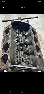

Nov 26, 2024
12

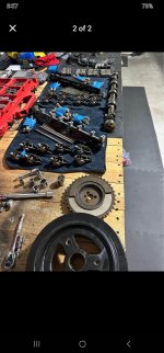

The internals look great. Don't think it was ever submerged.
50,783
Not sure I would have pulled it apart that far.
50,783
Boat could have been rolled from a marina to the beaches
