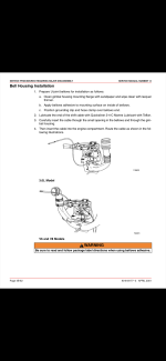

When the cable is pushed in it will hit the back of the flywheel housing, it then has to be pulled to the starboard side then routed up to the shift plate.
dubs283
Jul 27, 2005
5,341
The lower shift cable comes through the gimbal housing and routes between the flywheel cover and the exhaust y pipe
Then routes up and between the exhaust elbow/riser gap next to the remote shift cable and attaches to the plate
Scott06
Apr 20, 2014
7,023
See attachment from factory manual
I found it best to pull the inner core out, then push a weedwacker wire up the cable to the shift plate and tie it off, pull the cable outer sheath out through bellhousing. Use the weedwacker wire to guide the new outer cable up and around the exhaust and flywheel cover
