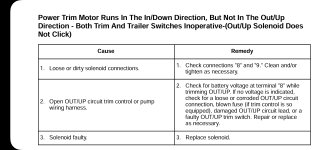

I found this posted by the late great Don S

Tested the up solenoid connections with test light. No 12v when operating trim up and trailer up buttons. Checked fuse and main plug coming into pump from mm J
