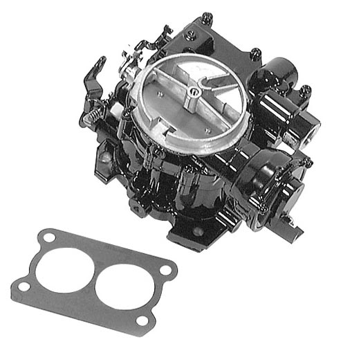

TKS carb (note the black solenoid valve on top left)
Merc carb

TKS came out in ‘03 or ‘04. Unless his boat was repowered, it won’t be TKS.
