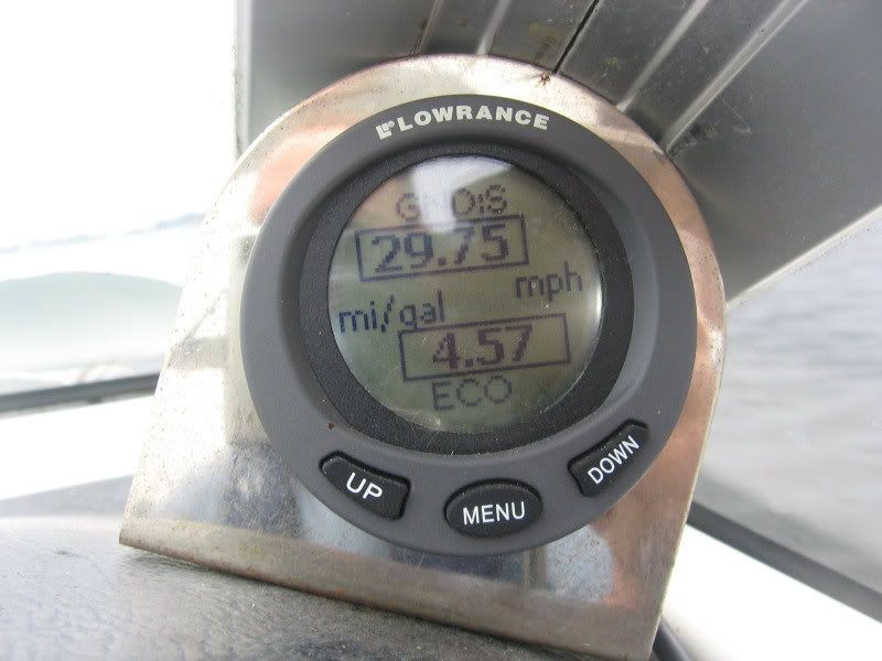

Howard Sterndrive
Nov 5, 2008
4,603
Re: Mileage
My Lowrance LMF-200 displays GPH and MPG
definitely affordable otion, although I question the accuracy at trolling speeds.
I never bothered to learn all the LMF200 features... I find it very unintuitive, evidence by things like GND:S meaning ground speed (why?....not designed with english in mind I suppose)
this is how I left mine set as I was pretty happy when I got this figured out:
