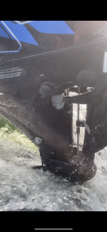

So I got out yesterday for some test runs. I did note that the water level is running about 1/2 below the upper plate just like the above photo shows
Ran with the OEM prop Averaged 11.5 Mph at 4600 RPM. New Prop 10.0 Mph at 4400 Rpm. I will say that it seems to accelerate a little faster with the so called lower pitch prop but over all still seeing a rev drop.

You said that the water flow is passing around 1/2 below the upper plate, in post 2 the water flow is skimming right under it, is it possible to lower the motor a tad via the jack plate or with removed jack plate for motor to sit on middle transom for the water flow to match post 2 pic ? Once there with the motor revving at near its max wot rpm range of 6 K, the combo will plane slight faster than now on flat calm water cond when at full throttle from a dead stop. Remove your current doel fin and use it as a paperweight or book stand LOL!!
The current pop installed with which you've done those water tests is the right one the boat needs, going for a one + pitch will lessen the wot rpm range a lot which will turn counterproductive when adding another boater and extra gear. On this scenario ideal is for the motor to run around its middle wot rpm range, not under with current prop as a 9.8 HP it's a very basic under powered motor used as a main for such application.
There's no issue running wot with you aone with current prop as its within the factory max wot rpm range...
