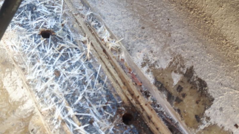

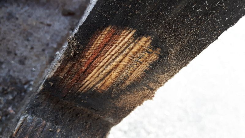

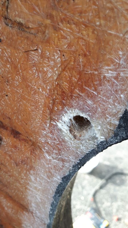

transom hole - clean dry yellow wood

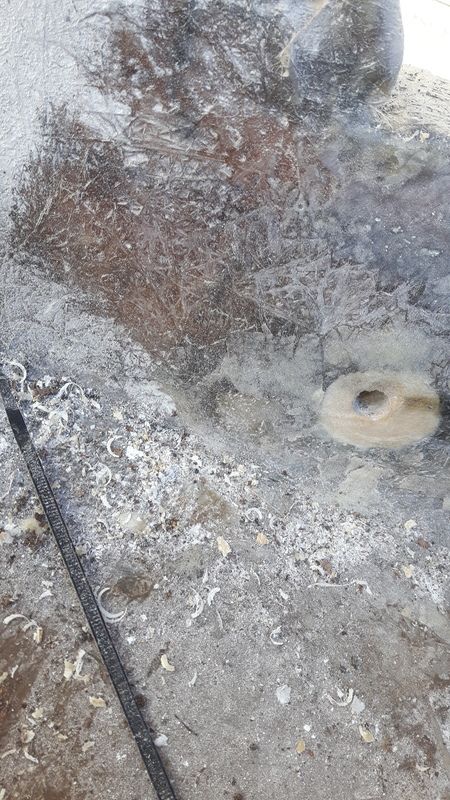

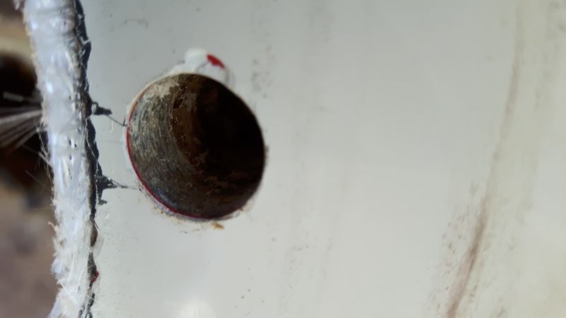

transom drain plug hole that i dug out as i filled it with peanut butter and then drilled through it so NO wood will ever be exposed to water

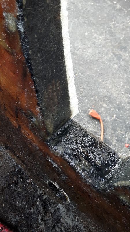

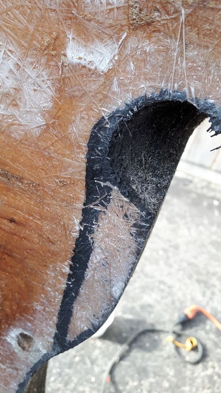

i sanded away the factory black waterproofing paint - this is the BOTTOM of the transom keyhole and again - clean dry yellow wood
i fiberglassed the entire keyhole to protect it from any water that may fall into it

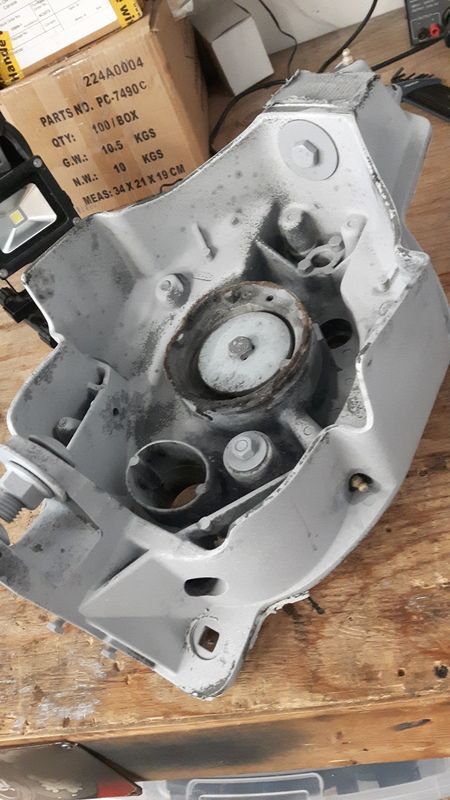

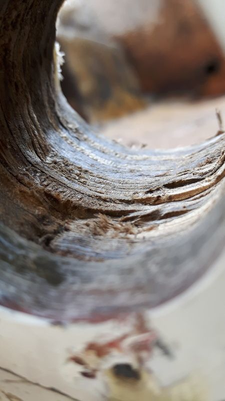

i cut away some of the engine mount skin to inspect the condition. they are still solid though hard to tell it was still good wood

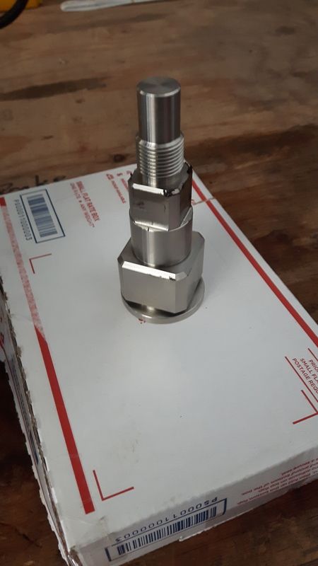

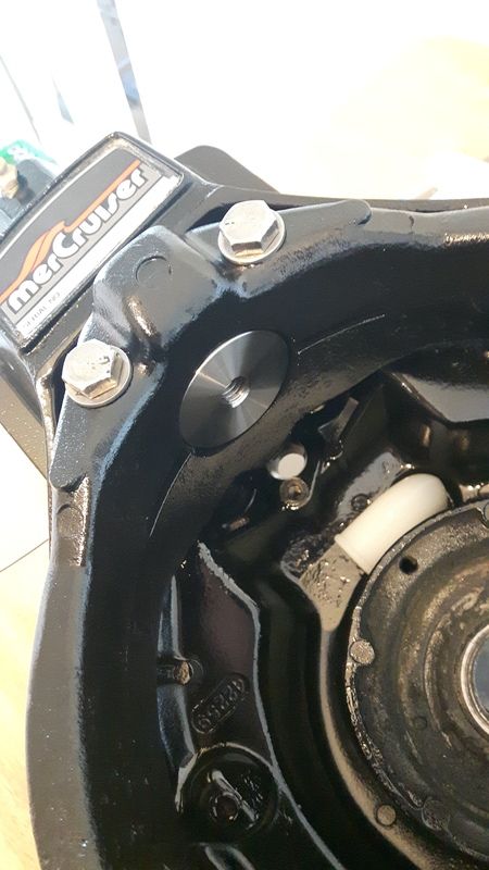

NUWAVE marine stainless upper swivel shaft pin

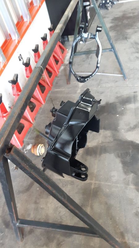

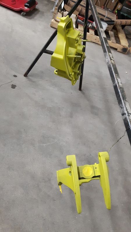

ZINC CHROMATE PRIMER
peanut buttered transom drain plug hole - i put 2 layers of fiberglass over it to cap it off nicely but i didnt get pictures just yet

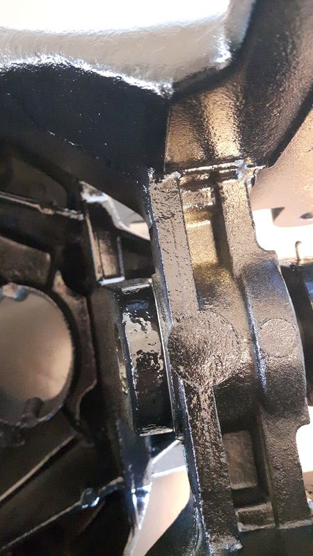

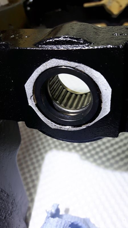

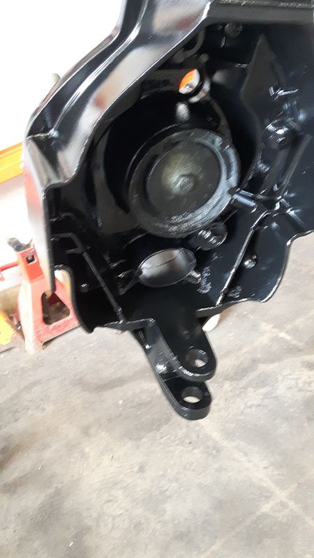

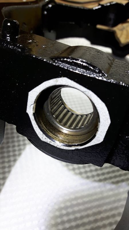

new seal and bearing - i will finish off with more black paint around all the seal holes

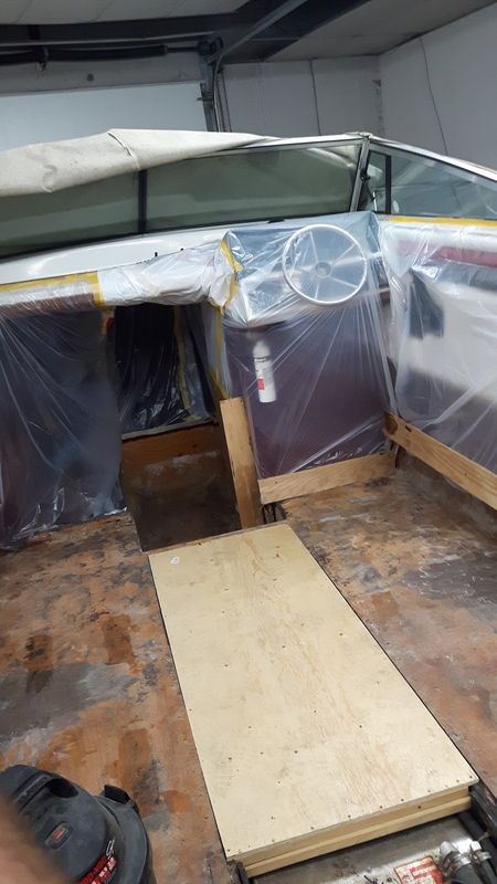

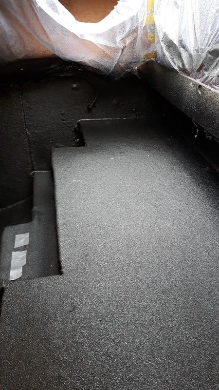

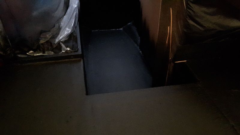

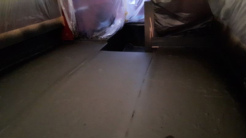

all masked off for the spray in bed lining - just needs a final wipe down. the windows have been masked off as well

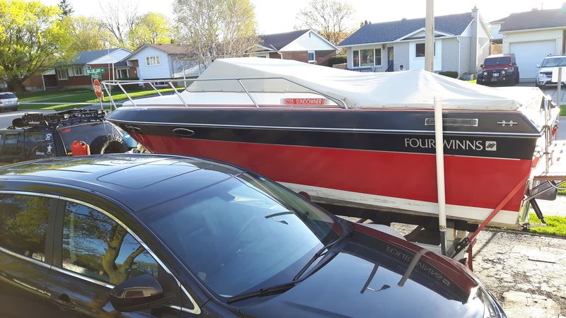

Do you have some pics of the outside too?

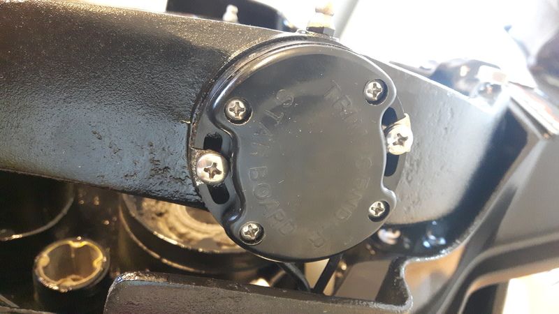

new trim senders in place

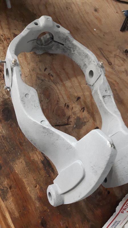

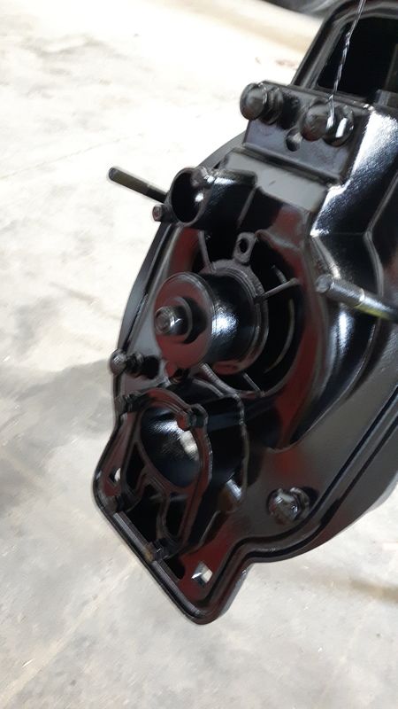

gimbal ring back in place and spec'd to clearance

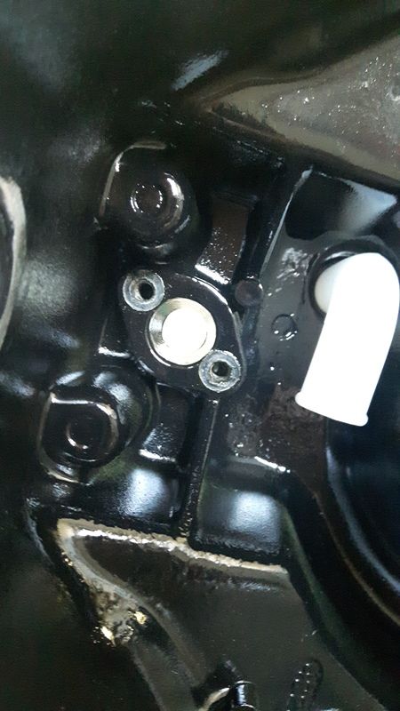

the new NUWAVE marine steering pin installed

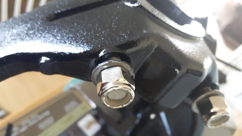

all new lock nuts throughout

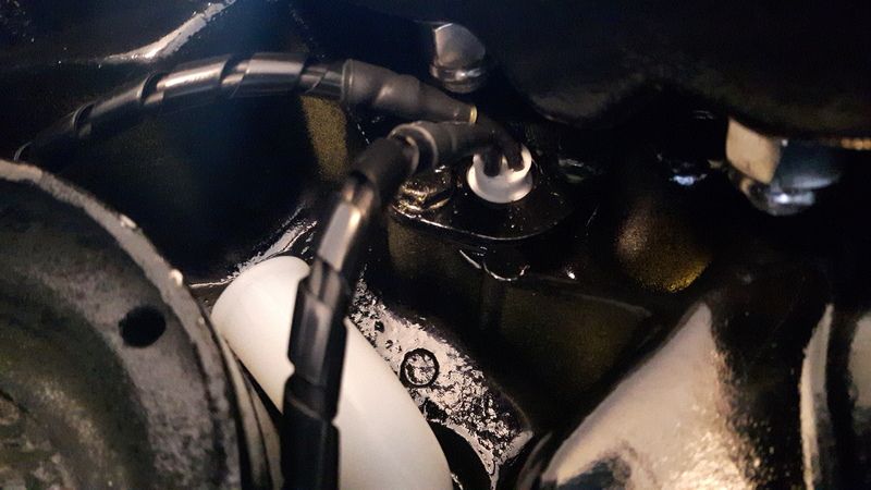

new water tube and grommet in place
pic before the new steering pin seal goes in

Wow! i dont think ive seen a bedliner done in a boat before! that looks nice and should be perfectly solid!! are you gonna paint it white?
fieromx3
Nov 28, 2011
131
Im gunna buy sheets of Eva foam which is the stuff SEADEK is made of and put it down as the flooring. Thr sprsy in liner was done to help aid in a complete waterproofing and sealing. Hopefully i can get the engine back in this weekend!
