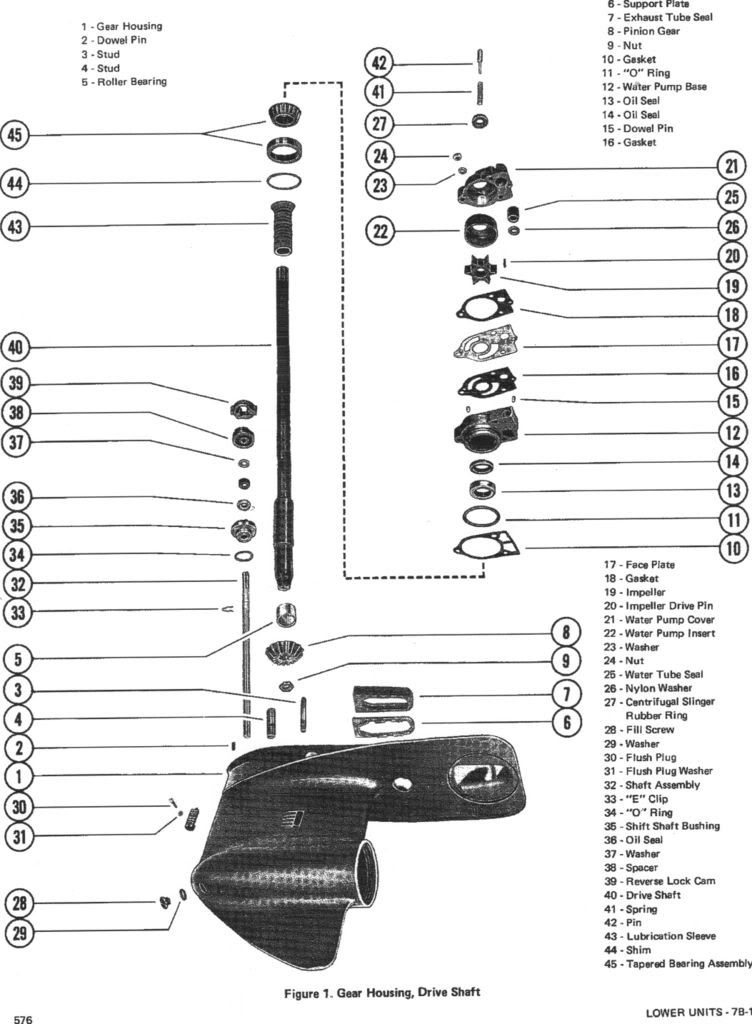

Alright i got it running. i ordered the new impeller and repair manual from iboats. but it won't be here until the 10th, today is the 6th.
i'd like to take it apart and see if there is just something clogging up the impeller line so i can run it this weekend. so, where do i need to start to drop the lower unit and find this impeller?
