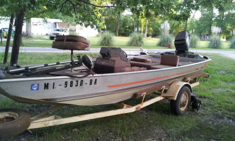

Hey guys, got a deal on a bass tracker from a buddy that quit fishing. Boat was running ok before he put it up 2 years ago but he doesnt fish anymore so he sold it to me. I'd like some basic info before I get started with it, such as where to look up the model year, what fuel ratio, and any suggestions for me before I get started with it.

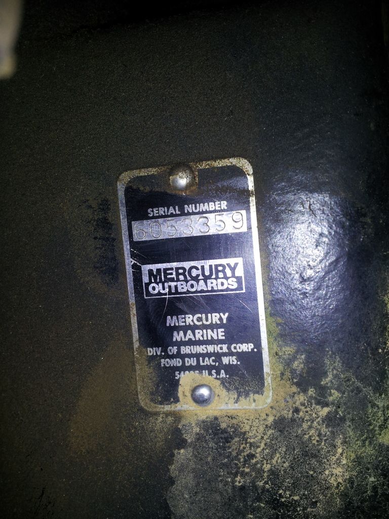

Serial number is 6053359. Looks like it needs a new fuel line, I've always had johnson stuff in the past, this one has a different tank fitting with a probe sticking out in the center, and has a hose clamp on the motor end. Should I change that out to something else or are all the mercs like this? Any help is appreciated.

I did figure out it was an '82 model from a google search if that helps.
carholme
Sep 4, 2010
4,845
Re: Need Help Waking up a 40hp Merc from a 2 year nap
It is a 1982 and a model:
1040522 MERCURY 1982 40
Parts Listing:
http://www.crowleymarine.com/mercury-outboard/673.cfm
OEM Service Manual P/N: 90-42794--1
Here is a condensed version of the Clymer manual which will help you until you get started. Let the page load for several seconds and then download soonest to your computer as the link is short lived.
http://web.ebscohost.com/serrc/pdf?...8-9e83-d5abe1edf486@sessionmgr14&vid=4&hid=10
Like any other engine that has sat for a period of time, impeller change, LU oil change, wiring condition, etc. 50:1 fuel/oil and give each cylinder a good shot of the mix and let sit for a few hours before turning the engine over.
Good luck with your new toy and I hope everything works well for you.

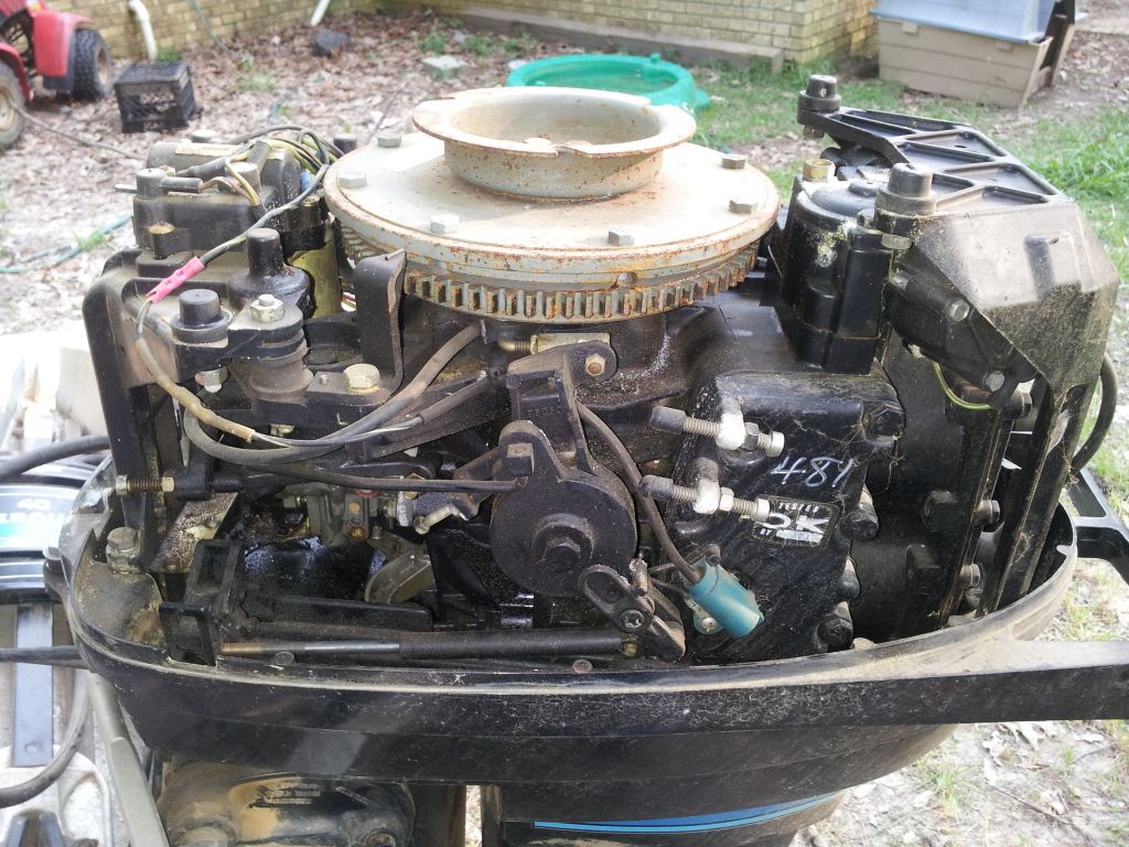

Motor runs great, thanks for the help. Peeing water like me with a six pack. Only one tiny issue:
Gears grinding slightly before getting into reverse, maybe a second or two (is this normal for a merc?) And yes it is idled all the way down before making the switch.
Secondly, the motor is not "locking" when going into reverse i.e. the push rod is not engaging the mechanism that keeps it from rising when throttled in reverse. I did notice the plastic cam was pretty bad looking, maybe i need to pull the lower again and replace it?
