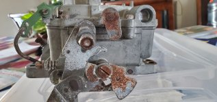

Hello, I have a weber/afb 9600s carburetor for my Maxim 1800sr boat and I was about to rebuild the carburator and notice the link missing. I'm the 3rd owner. What I need is the length from hole to hole with the link on. I can't seem to source it from anywhere so I will have to make one. Hope these pictures help explain what I'm talking about.
Any help is appreciated.

Ayuh,...... Welcome Aboard,..... I'll tell ya a secret,.....
The Edlebrock 1409 is the exact same carb, that uses the exact same parts,.....

Wow thank you, I will look for edelbrock 1409 linkage kit! It's almost spring time!
