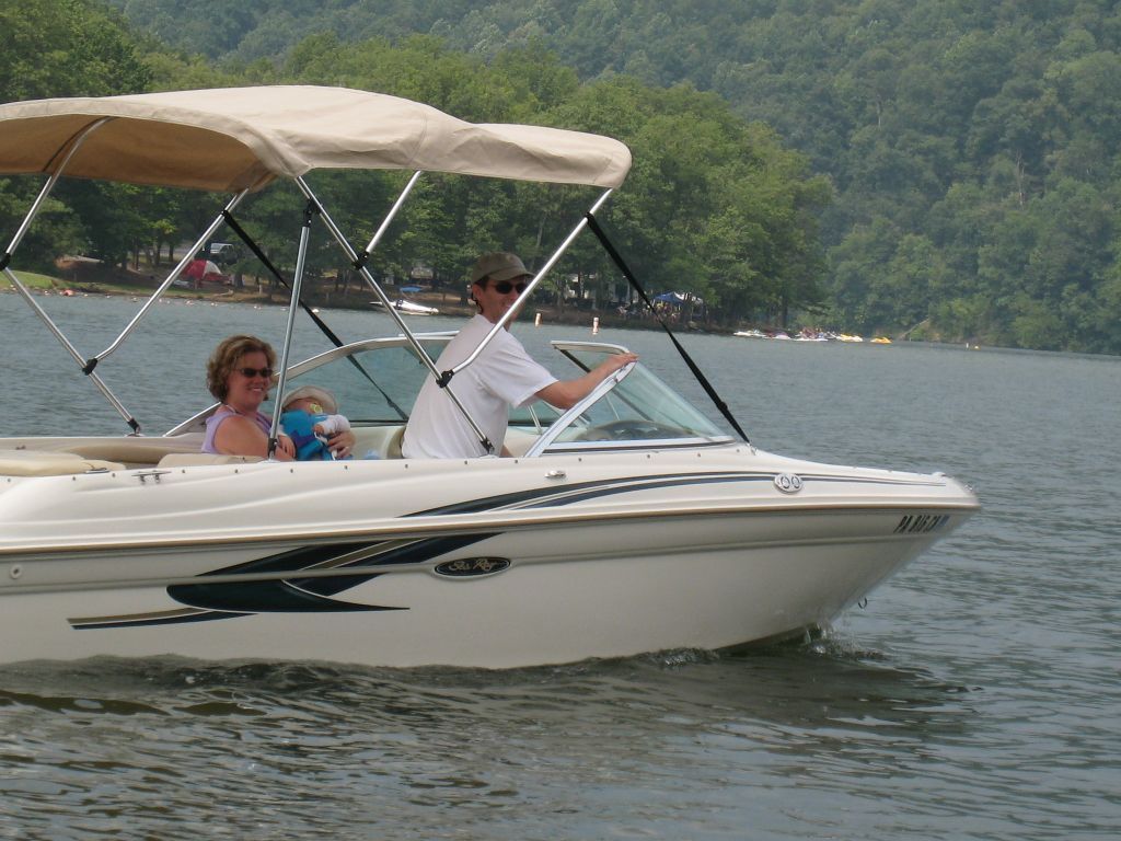

I added a bimini to my Sea Ray back in 2008. The top was purchased through Overtons and wasn't too bad of an install once you get past the fear of drilling holes into your fiberglass. One trick I learned for drilling holes is to start the hole by drilling in reverse until you get through the gel coat and then switching to forward.
